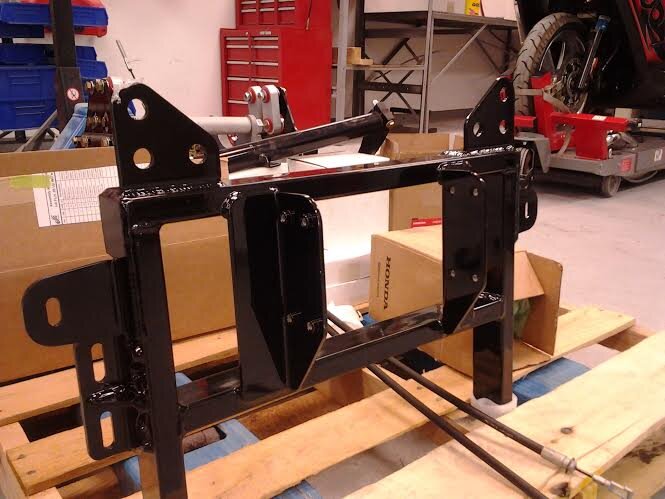

Hi this is Jaime from Lehman Trikes. I happened across this thread today and thought I would run back and ask our conversion guys. They said if you don't have a hitch kit, then place a 2x4 between the hitch mounts on the rear frame (I took a picture of it - below) and then jack it up. Hope this helps!
