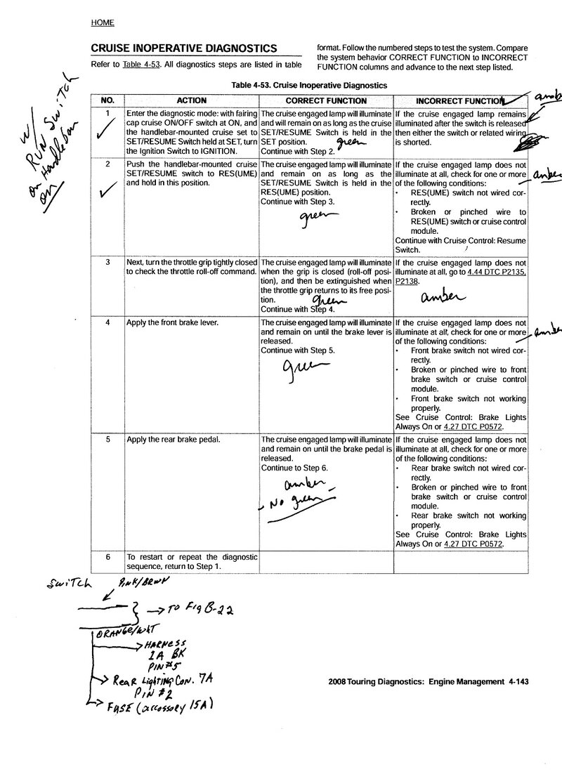

While riding today I got a check engine light. It was intermittent. It would stay on for a while then go off. And...in a few minutes it would come back on. Engine seemed to be running fine. My cruise control quit working. When I got home and let it cool down I ran a code check on it. The only one that it showed was P0577. How do I systematically begin searching for the solution?
Bad cruise switch would be my guess...Have you changed the bars or gripes lately.:Shrug:
Could be, I will have to check it out. But to answer you question, I haven't done anything to the grips (that I know of). Any idea what it would cost to get another switch?
60 to75 Dollars, But i wouldn't run out and get one yet, It just might need a shot of contact spray...And i'm sure someone else will chime in with a little more info than i can give...
I am on my way to figuring it out. (I think) I have made it to table 4-53 "Cruise Inoperative Diagnostics" in the electrical shop manual. Right now I am trying to digest it all, tomorrow I will go outside and begin trying to follow the chart.
OK, now I have reduced the search to the rear brake switch circuit. The switch itself or a broken or skinned wire. More to come, I am sure.

Finally!! I replaced the rear brake light switch. No check engine light, no codes, and rear brake light comes on when pressing rear brake pedal and, and, and the cruise control works as it should.
Something to keep in mind, Harley has had problems with these switches and wiring being to close to the exhaust and burning them out.
they supposedly have a cure in a different switch.
My experience?
I had trouble every time I replaced a Harley switch with a Harley switch. it was burning out due to too much amperage draw from the brake system.
CURE?
I went to the auto parts store and bought a brake switch for a car, Screws right in, no more problem.
