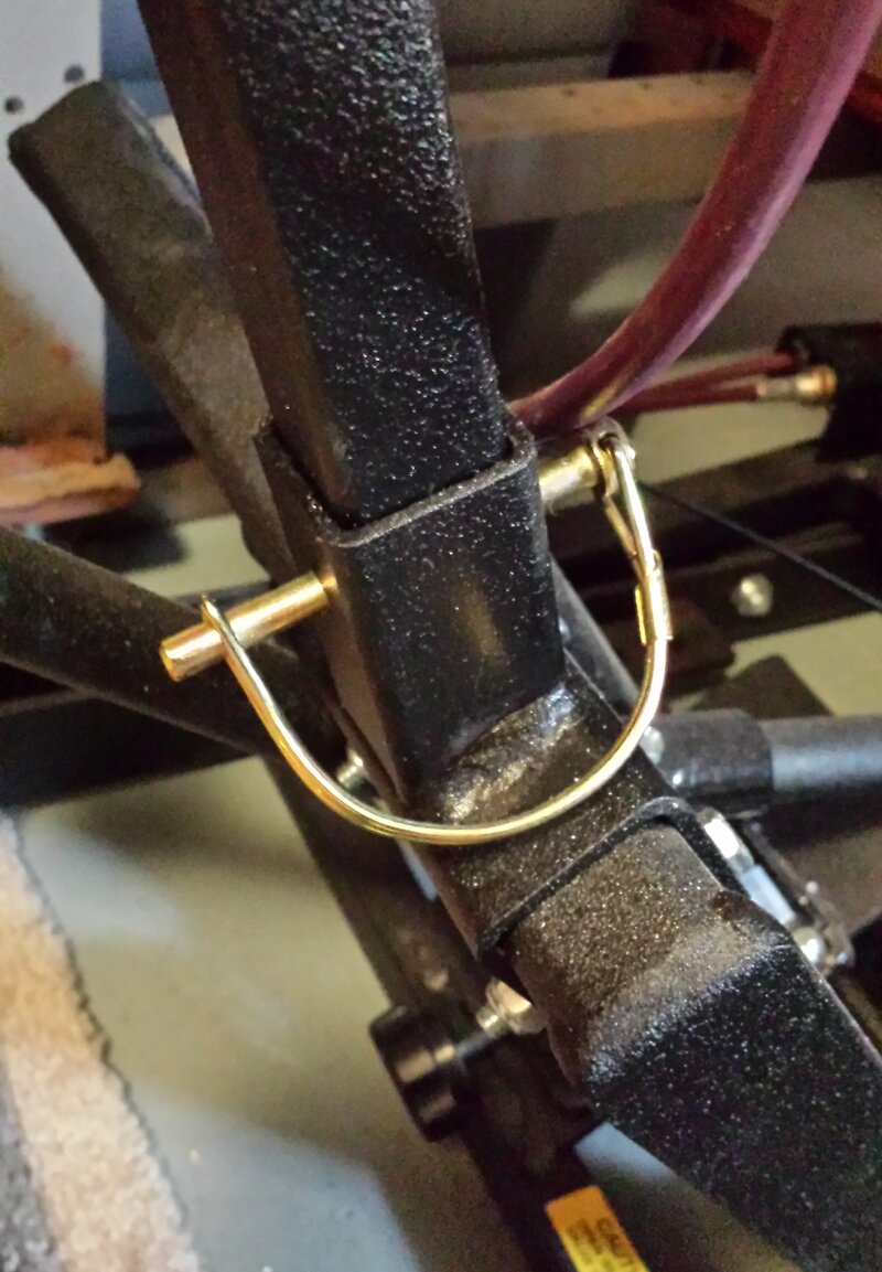

The more you use it ... the easier it is to find the sweet spot. Almost every trike I have had on my J&S jack required rotating the cross-over muffler clamp. Once that clamp nut is out of the way it is easy to get in position. I added a pin (couple bucks at John Deere Dealer) to my handle to make moving it around easier.

Good idea. Thanks a lot.
