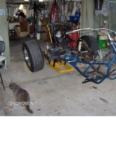

Hey guys.. just got my first trike. Very excited! Lots of work to do as it was someone elses unfinished project. I dont mind the challenge and know it will be worth it.
Question.. how do i know what year my tranny is??? i need to buy a complete shifter assembly.

As to shifter versus year - doesn't matter what year, all the four-speed shifter mechanisms were common for all the aircooled VW's. If you just want to know what year you have you can post the tranny # (on the side of the tranny - location may vary by year) and someone can surely look it up online). You can get a shifter mechanism out of any old air-cooled VW or from a buggy shop.
