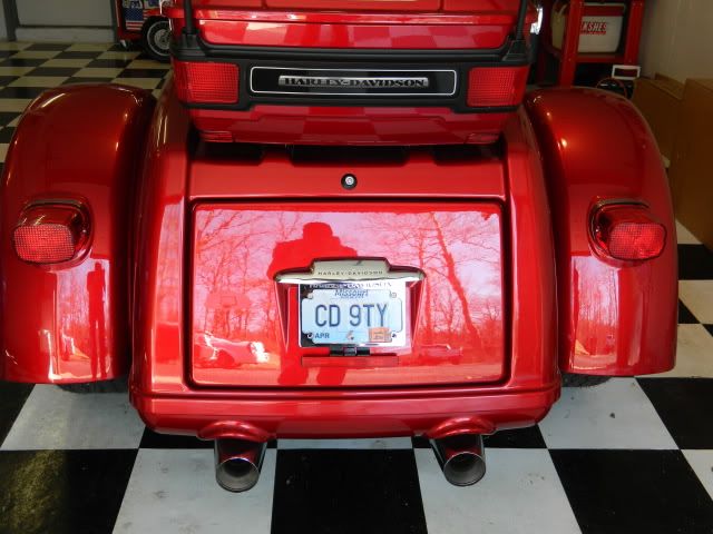

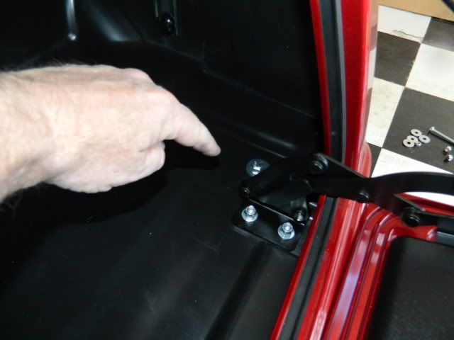

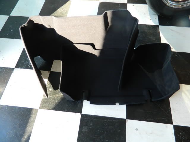

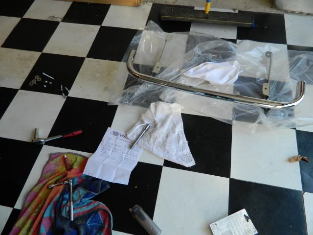

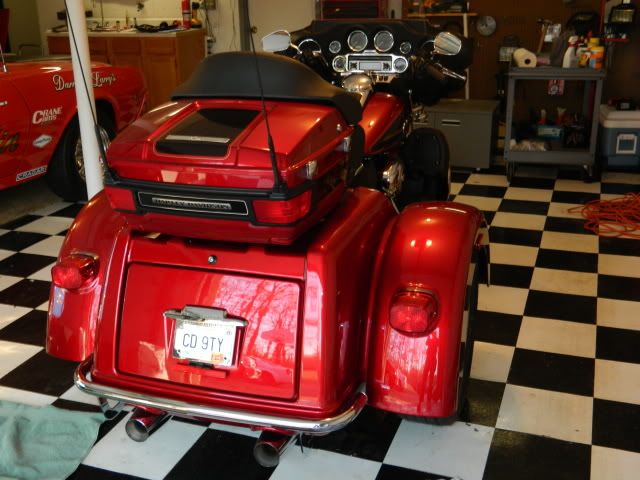

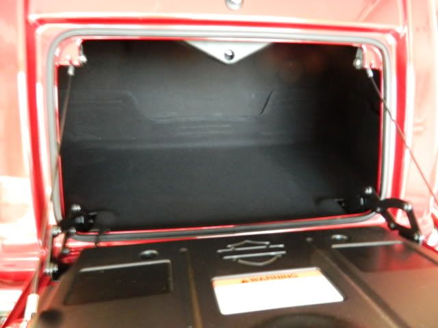

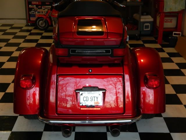

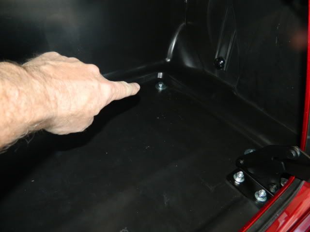

Picked up the Chrome Trunk Rail from Harley and installed today. Looks great and very easy install. Just four bolts , open trunk area and take out insert and locate four bolts that hold body to frame. Remove the shorter bolts and replace with longers ones provided. Takes two to hold bumper to body to get started by securung nuts. Use torque wrench and tighten. Place inserts back in trunk area and your done . You only need to provide the Loctite.
Part # 83825-09A
Here are a few pics,,,,hope this helps. I know a few was asking here on the forum about install . ;)

I think it really adds to the rear of the trike. Needed a little something back there. I seen Kuryakan has a nice chrome piece that goes around the trunk lock. I think that would dress it up some more. May be my next item...don't know if anybody has installed one yet.
