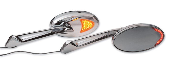

How about something like these.

As far as getting info from Harley, no way. would drather get information from the forum,usually tried and true. Don't want to put on mirrors, just some small lights on nacell. Good thought about the mirrors Tucci, will look on Harley web site on how they connect them on a freewheeler and will substitute small indicators instead of mirrors.

I had a similar thought when I was relocating mine due to a front end swap (for a springer) that did not happen. But in that effort, I bought a set of Rivco Mirrors for the same reason. Here they are:
They have great forward visibility (LED powered like Jack was referencing) and rear facing indicators in the mirror that both add to the rear facing turn signals on the trike body and are obvious to the rider that the turn signal is flashing. To MDO's point, my local HD dealer was consulted and it was not a problem to install these on the Trike (mine is a 17 Freewheeler) stock front end or otherwise.
