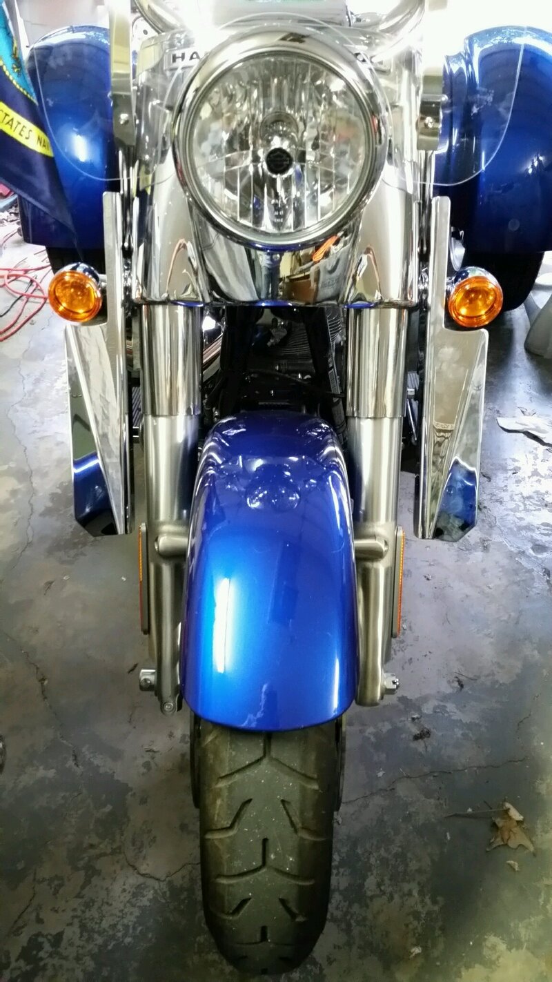

Just got a photo of mine when my guy finished installing them. These are very substantial and chromed beautifully. I hope to ride tonight after work and be able to report less wind!
JES Custom Wind Deflectors
I got to use them on a good ride out in east Texas, and it's soooo much better. The only complaint I have is that my right calf gets much hotter...working that out.
