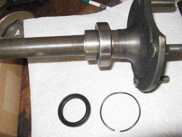

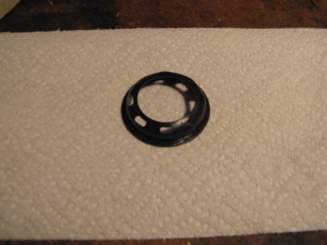

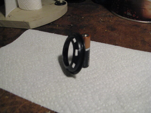

The spring clip acts as a spacer. It does move freely when you remove the bolts. Reuse it. Hang on to your wallet. They do have the complete kit. about $60.00 as I remember. the bearing is Chinese you can but for about $7.00 at a bearing shop. $20.00 from Champion. The last picture is what champion calls the cage seal. The real world calls it a seal protector. If you don't destroy the spacers, this is the only part you need to buy from Champion unless you can find somebody to cross reference it. I could not. Suzuki Samurai was too big.. Mabey Tracker. too hard to find and not that expensive. http://www.championsidecars.com/

Thank you for your help I pulled the axle out by removing the plate which holds it in....If I left it on I would pull the bearing off also making it harder to get out. The bearing is shot and several bearing are missing and the oil seals were also destroyed with the axle flopping around.. Feeling the races inside the axle housing I found the races to be thicker of the top than the bottom?? I don't know if this is normal? I have to check the roundness of the races...Getting them out is going to be a job...I was thinking about heating up the outside with a touch to expand it and maybe the races will move then?? ANY Ideas out there in trike land?? on how to get them out?? thanks for the help...zorro
I called champion today and found out mine is a Toyota rear....If the universal joint is bolted to the pinion by 4 bolts and nuts this model is discontinued with no stock on parts not even reference numbers to get replacement parts. Today I went to Auto Zone and brought a bearing crossed reference with the number on the old one. ($24.21) Now I need to find a place to get the bearing off the axle and somehow get the oil seal. Is there two and outside and inside one? and a seal protector......I was told the kit you find on the internet is for a Suzuki....I'll check again.....Thanks for the help deeply appreciated....Zorro
