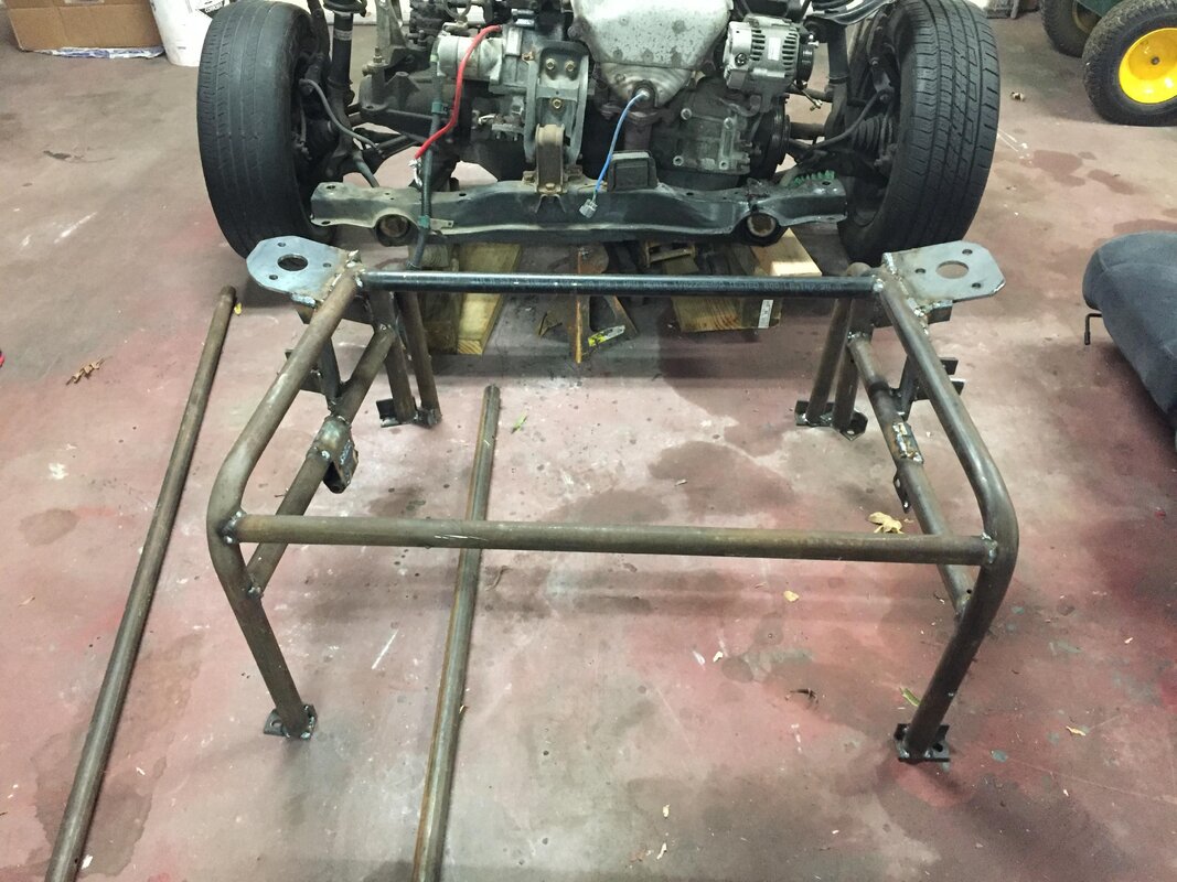

Started on the engine cage, not the prettiest but I've got one side mocked up and tacked together. As soon as I get a motor mount built for this side I'll start on the other side.

I've the cage tacked together; time for some finish welding plus adding some gussets to the strut and upper control arm mounts. Then I think I'll start getting the frame rails figured out.
