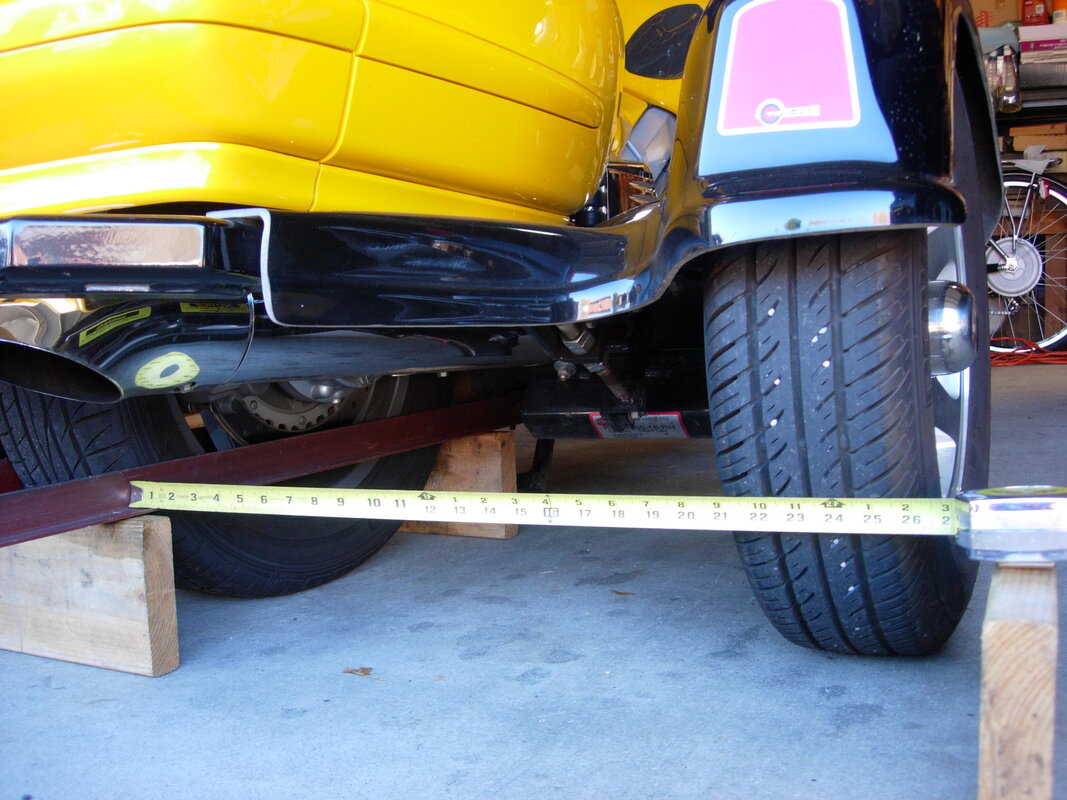

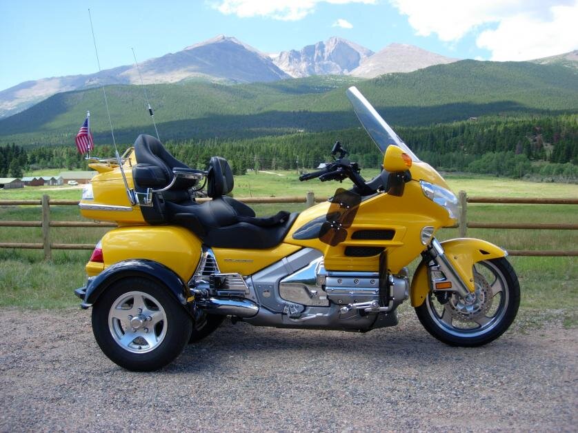

I bought a 2009 GL1800 in April 2009. Installed the Tow-Pac kit with 12" tires. I eventually swapped out the trailer tires for Kumho Power Star 758 in size 155/80R12. Just checked their website and this tire may be discontinued. Checking for the size brings up several tires in that size. I may be getting back to a Tow-Pac on a 2016 GL1800 soon so will be checking on this later. One thing about switching to these tires is I had Big O install them and balance them.
