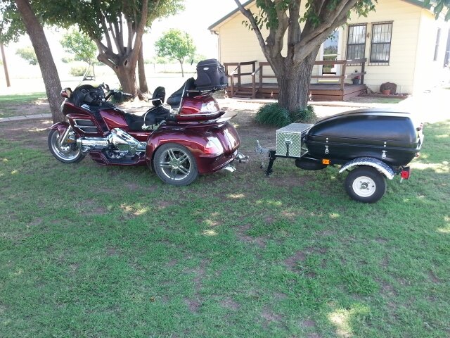

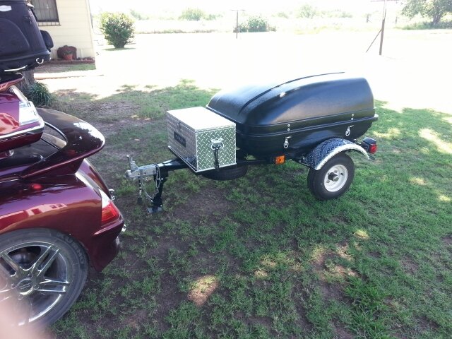

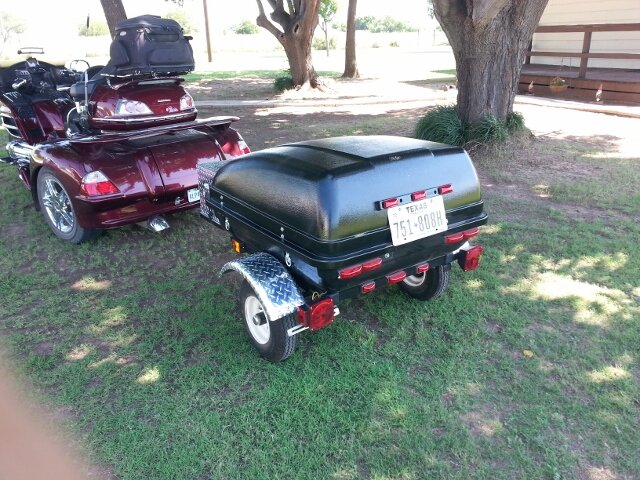

Thls post is just to show off. Modified Harbor Freight Tag Along for the Lund Diamond Plate ice chest on the front. On my last trip I found that one of the fenders had broken in too. Order the fenders you see now on line. Had to make some adapters to mount them to the same brackets. Also, moved the license tag up as it kept dragging the ground while moving it by the the tongue. The tongue jack is just a rear stabilizer like is on my trailer. Just pops down and is adjustable. Also added some small D ring tie down for carrying extras on top(EZ UP and bag chairs for camping. Just thought mayby some would like to know. (Besides, I needed the practice). Thanks for viewing!

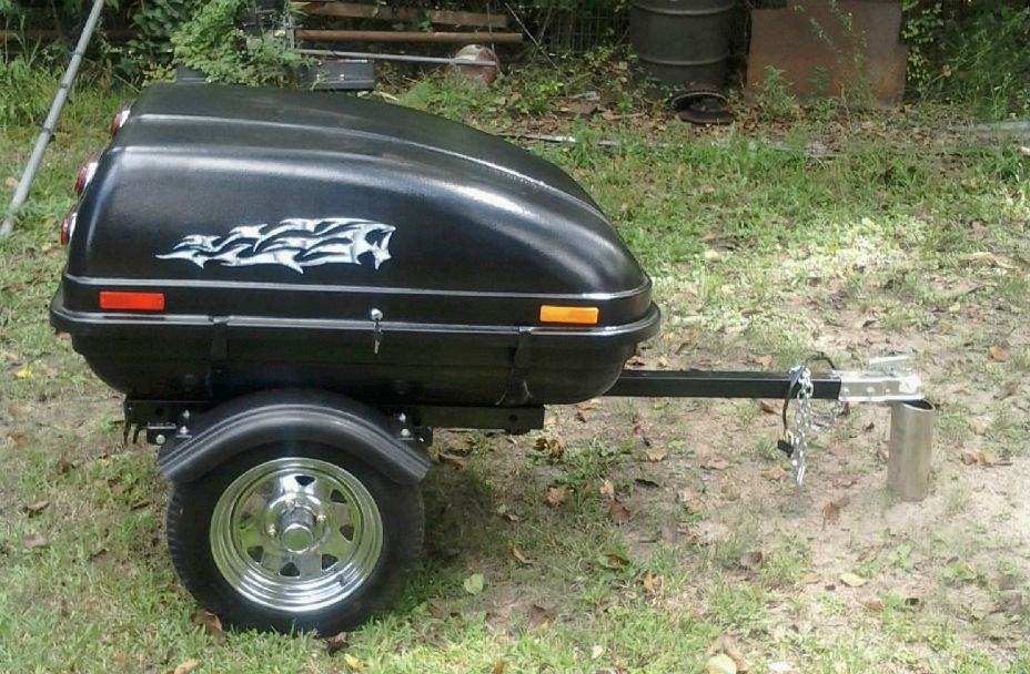

Looks good, I've got one in my garage that I built about a year ago, still working on it, haven't had time to even wire it up, it hasn't even been tagged. Maybe I'll get it done in time for the Maggie Valley trip.
ECH929, how does the top hold up with the chair load? Considering something like that for mine. I kinda like the chrome fenders. Think I saw something similar at Tractor Supply. Since I put the 12" wheels on it, the LP doesn't drag anymore.... so far. :) and I need the tongue jack/slider.

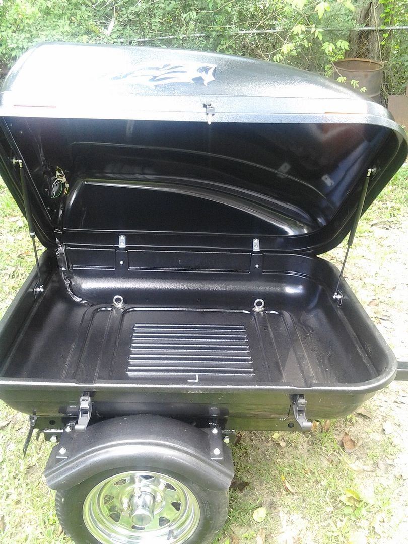

I used eye-bolts to mount the box to the frame, gives me a place to hook bungie cords to keep stuff from sliding.
keepinon
I could only find the fenders a E-Trailer online. One of the original fenders broke and I had to replace it. The load on top is only two Sam's Club aluminum bag chairs which are not very heavy. The other item on top is a First Up awning for which I also carry the screens that go around it. In the trailer I have two Coleman folding cots with pads, extra self inflating pads too, a fan, camp stove, coffee pot, bedding, clothing, etc. Also carry lights for the gazebo and extension cords and other "necessary" stuff. Make grocery run after setting up. Can't wait to go again!
Great, thanks. That's about what I'll carry, just the fold-up fatman chairs on top. Tent & other necessities inside.
