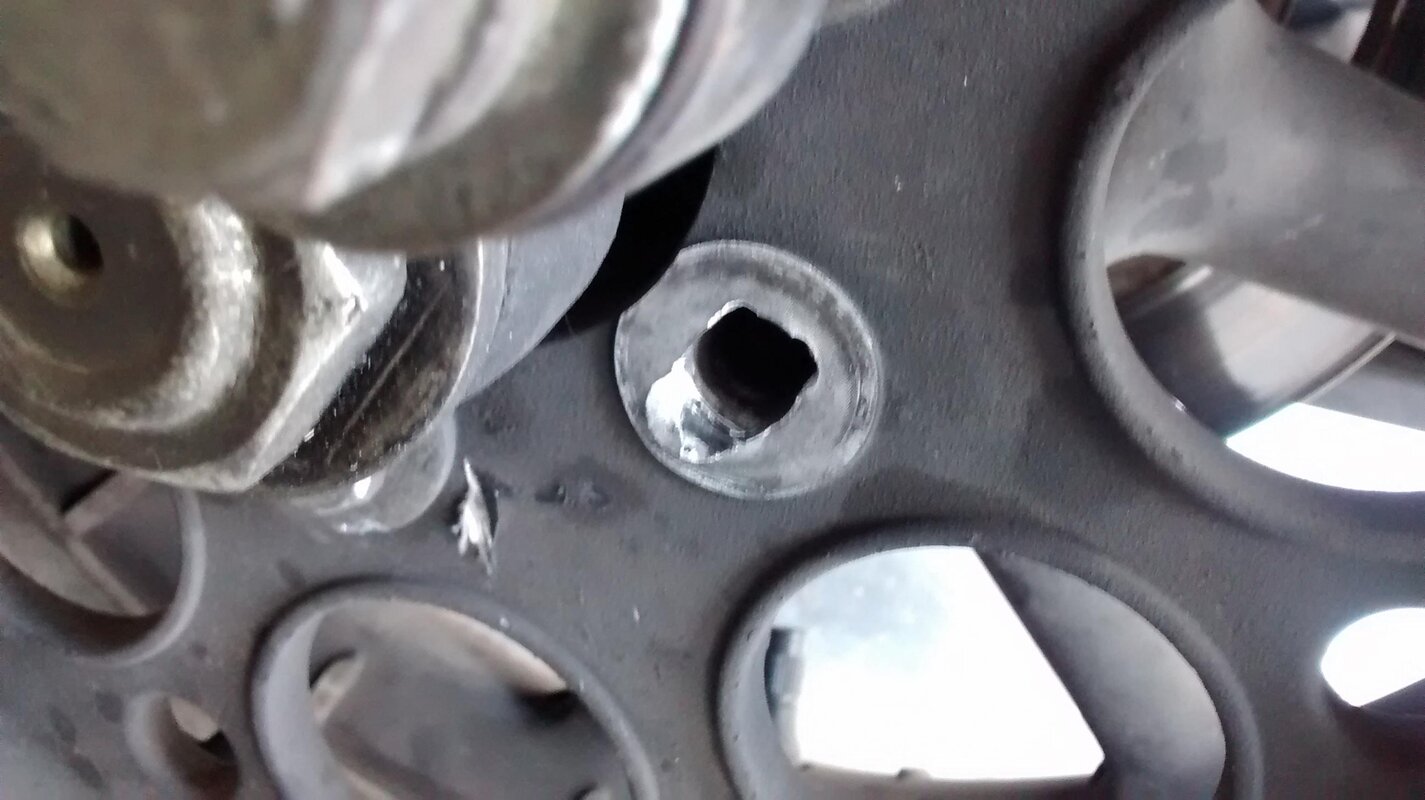

Well I found the culprit. The bolt backed out of the belt pulley and was hitting the lower shock mount on left turns. The bolt backed out far enough yesterday while I was going down the road to hit the shock mount and shear off. I just left my driveway when I heard a snap, I turned around and went back to my garage, Checked the bike and saw the hole, now to get a easy out and order a new pulley.

removed the rear wheel last night. All 5 bolts that hold the rear pulley on were snapped and I would have to heli coil all 5 holes, So I did the next best thing told my wife I need to go shopping for a new wheel.
