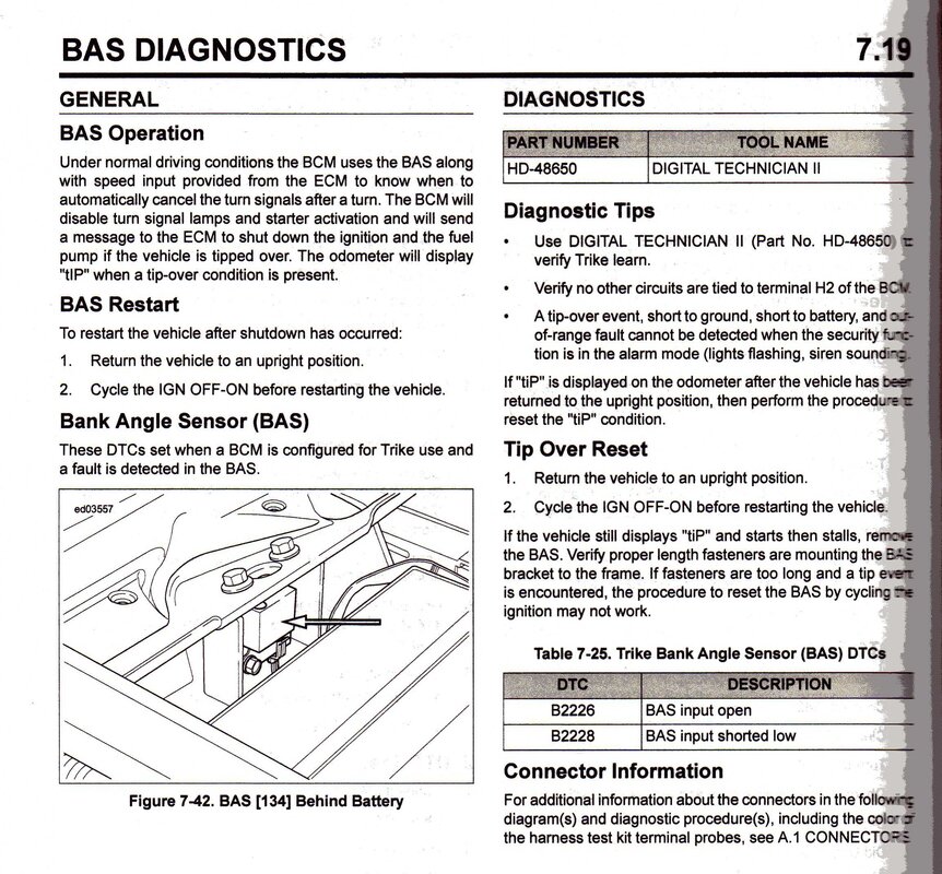

I've got a friend stranded. Where exactly is the tip over switch located?
tIp on mileage indicator ... off/on ignition is not resetting.
Bob :Dorag:
He's getting a pick-up to take to the Dealer for service. I still want to know where this sensor is located. I can't find in manual. :confused:
Found it. Bank Angle Sensor page 7-50. I'll bet it came loose from it's position behind the battery.
Bob
Waiting on final outcome from Dealer .... it was towed in. BAS by battery was firmly attached. I'll post an update when I hear what it was.
Bob :Dorag:
