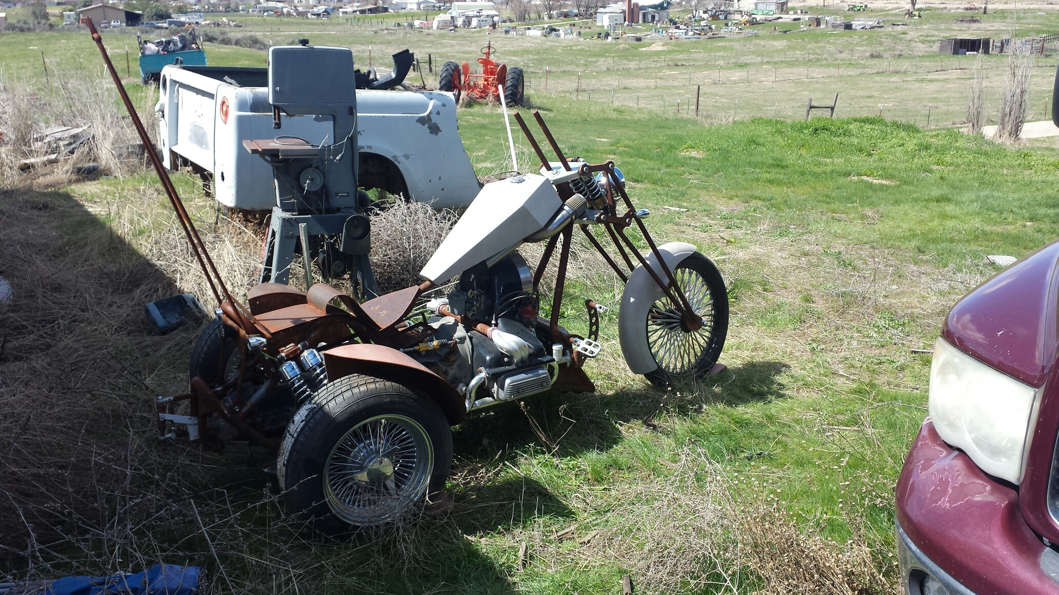

what I have is a old kit from I think Badass trikes plans with a 1600 VW . I picked it up along with a box of parts and build receipts .she is for the most part complete in mockup. however it has set for several years and not finished . I'm about finished with the handle bars and other little items that need done before I tear down and paint . there are some things however I don't care for . I would like to change the battery box to something along the lines of a Faux open top round oil tank , to house the battery. what would be the smallest type battery that would work for the VW engine. I really don't want a large auto type battery shoe horned in there . I would like to keep it more old school and as such I'm also wondering about a speedo and tach. the box of parts that came with the bike has a mech. 2 + inch , handle bar mounted speedo from drag specialties that runs off the front wheel . I like the looks of having 2 small gages mounted on the bar . however I'm not sure this will work without modification to the sender that mounts on the front axle . I may have to change the gage out to an electronic type gage and sender . I have found a matching Tach but I'm not sure as to what type will work with the VW engine. I would like the tach and speedo to match . what tach should I look for ?
also I was told and I'm not sure the info is correct , but that it would be best to put a set of wheelly bars on the back ? is that really needed with the mid engine designs ? are the front ends anymore prone to rise then any other bike ? lastly front brakes . currently it has none and I would rather put a disc up front . to do so ill have to build and weld up a bracket to mount the caliper . that's not a big issue as I do a lot of welding and fab work . but I'm rather torn as to what type of setup to gather parts from . so I could use advise there
thank you in advance for any help you folks can give me .

That machine is one nice build I wish I could help surely the VW portion of TT can help.
