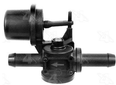

This is a typical Ford heater control valve
It will be in 1 of your heater hoses before the heater core
Most often the valve will either leak or stick

Pretty close. The heater valve on the stallion is more of what I call a butterfly style (doesn't have the actuator like the one shown). It's located on the top of the hvac box under the right rear wheel, can also see it by removing the passenger seat back. It'll have a plastic cover over it that snaps on & off & like others have said the heater hose can be your guide to it.
