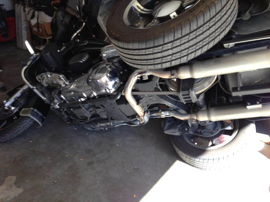

Just turn it upside down and do it.....bolts are easy to get to. While out it ya might clean the bottom a little.
OH ME!
Sorry about that. Looks like right lower and fender might be on the concrete. BUT, I got to ask.....how did you do that? :confused: Ramps involved?
He said 'don't ask.' But inquiring minds want to know. Next question: how did you get it back up on its wheels. Looks expensive for sure.
Believe it or not, not a scratch on it. There were a bunch of boxes to the right of my bike. Eased over on the boxes.
What happened. Was jacking it up to work on the exhaust mounting for my V&H slipons. I have two different floor jacks. The normal every day pump it 15 times and a NASCAR aluminum jack that you pump twice and it all the way up. Forgot which jack I was using when I tried to raise it to up jack stand under the side frame tubing. Thought just one more pump and it's where I needed it, with barely one little pump The trike just eased over on it right side. Duh !!!Lucky I'd put those boxes there earlier. My neighbor came over and we just eased it back up right. I was totally surprised the only this I had to do is re-just the mirror.
