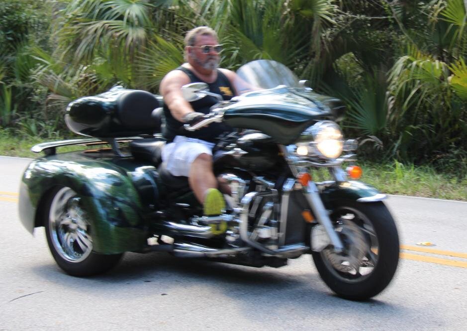

I triked a VN2000 last May. I used the American Trike independent suspension. Sam Camp from American Trike took my bike and made up the swing arm. Other than the VN2000 has way to much HP and torque and I sheered off the bolts to the axle, I have learned to resist the hole shots and have really enjoyed the trike. Motor Trike makes a kit as well but it is not independent but is a fixed axle. I saw one at the Ohio BTW State Rally. Did not look very impressive, he had to get a 2 into 1 exhaust plus it hung down , American Trike reworked my pipes so as to have dual exhausts.
