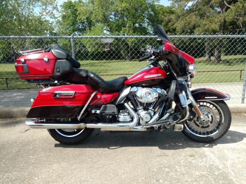

This is a 2012 Harley Ultra Classic Limited that we converted using a Roadsmith HDTR kit. The owner, Ron (Santaron1) is from just up the road in Magnolia Texas and is one heck of a nice guy. His nickname is Santa and he does look just like Santa Clause and does a lot of Santa gigs during the Christmas season. This build is from a few weeks ago, but I am just getting around to posting it due to having a lot going on with the flooding at the house.

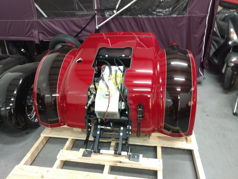

Uncrating the Roadsmith kit. Ron ordered pretty much every available option, including custom two tone factory match paint, running boards, lighted mud flaps, electric reverse, chrome wheels, chrome bumper, Love Jugs cooling fans, our 9 degree billet rake kit, HD sway bar and auxiliary fuel tank.

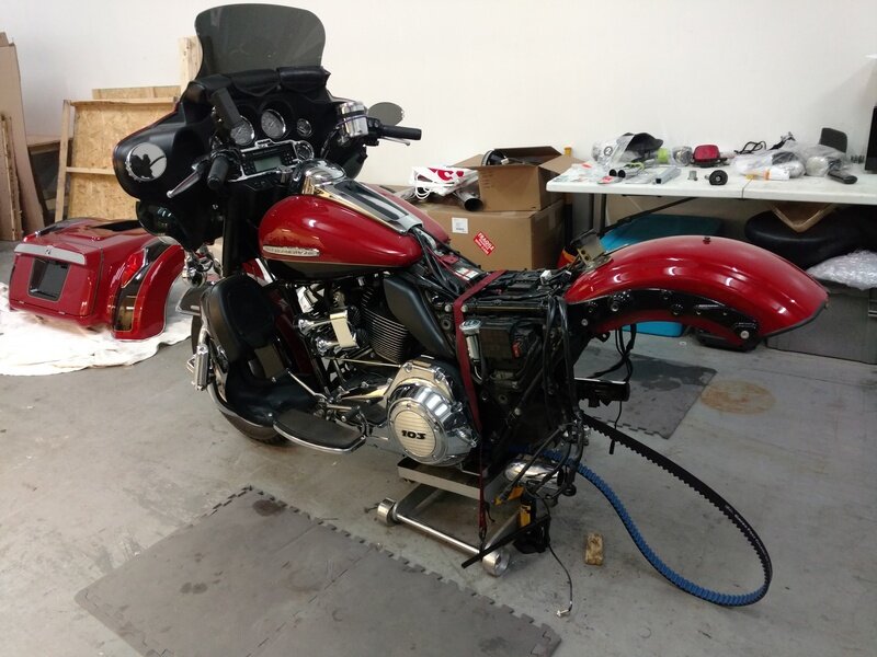

The kit comes assembled but has to be almost completely disassembled and the aux fuel tank removed before it is installed, due to the drive belt mating up to the rear drive pulley and the fuel tank being plumbed and wired. This is one of Roadsmith's more intricate builds and is pretty labor intensive...it is straightforward and well designed but not a quicky install.

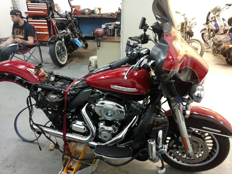

Pulled the tour pack, mufflers, swing arm, wheel and tire and brake caliper off the Ultra, also pulled the primary completely down and off and re-installed it using the longer drive belt provided with the kit from Roadsmith. The longer belt is necessary due to the longer length of the trailing arm suspension used on the Roadsmith kits.
In the background on the left is our mechanic's really nice springer ironhead bobber getting a complete engine rebuild and on the right a springer ironhead chopper we are rewiring and tuning for a customer. The blue and silver 06 Heritage is in for a trike conversion as well and I will be posting up that build thread next.

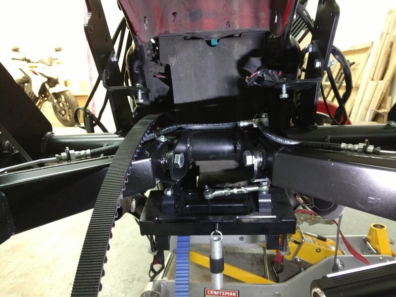

OK back to the build: Primary side view..after the primary tear down and new belt install. The rear fender has to be bobbed to fit the trike kit and notched for the aux tank. Thats a loooong belt huh?
This is the rear end subframe assembly and trailing arms which is mounted through the frame/tranny where the rear swing arm was previously mounted and also mounts to the Harley frame. The spring and heim joints are for the adjustment of the electric reverse which will go in next along with differential, axles, reverse, trailer hitch, etc.

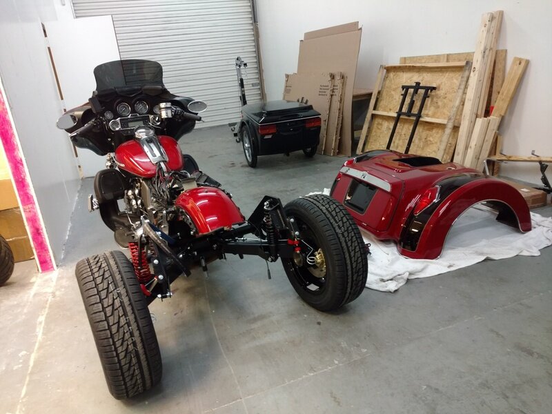

The Heritage is under construction now, its together running and driving but waiting on the body and tour trunk to get back from the painter. Its been delayed due to all the rain and super high humidity levels not being conducive to painting. To be a ten year old bike, the blue Heritage looks like brand new. The owner takes great care of it and it shows.

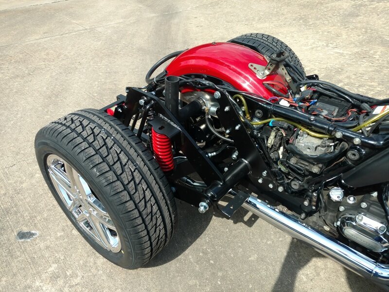

Here is a shot of the rear subframe and trailing arms mounted and the rear fender bobbed. The rear fender has to come off and be slotted to accommodate the fuel breather hose. You can see that although the kit came assembled, it has to be disassembled before mounting the subframe and trailing arm assembly to the frame and then reassembled after the primary drive belt is changed.

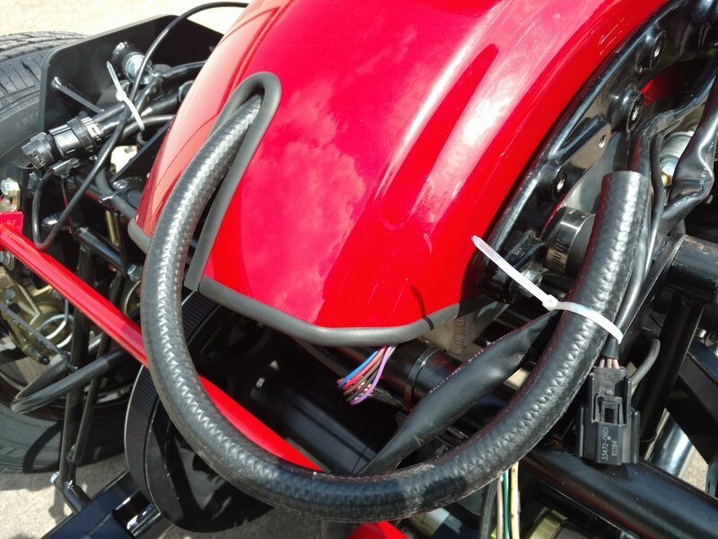

Here is a shot of the slotted fender. It is done using a cutoff wheel for the long cuts and a jig saw for the radius cuts. The fender is removed and taped off so as not to scratch it. (even though its hidden under the body)

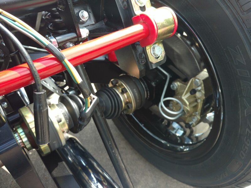

In this shot of the right rear (from behind) you can see we have installed the differential carrier assembly and differential and the half shaft axles along with the anti-sway bar.

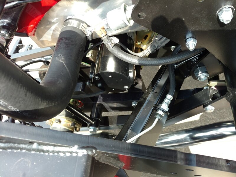

This is a view from the right side looking down, just in front of the tire, showing the aux fuel tank installed, plumbed and wired, the fuel pump installed and wired and the reverse motor and drive gear installed. The reverse motor pivot assembly and cables and handle assembly have also all been installed on the left side and adjusted, wired and tested.
Here is the same view but taken further back so you can see the detail of the mounting points. You can see how beefy the Roadsmith subframe assembly is and how the trailing arms mount to their pivot points. They have been using this same basic design for years but have continued to improve and refine the design so it has evolved quite a bit over the years.

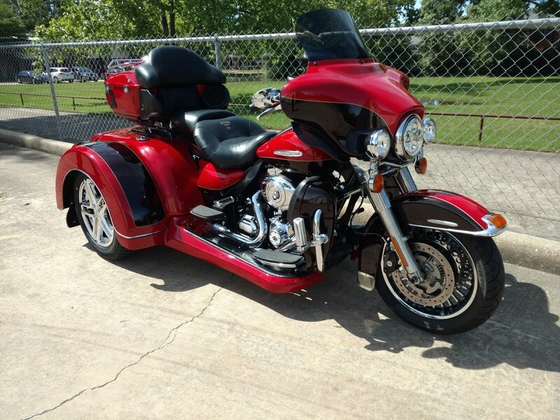

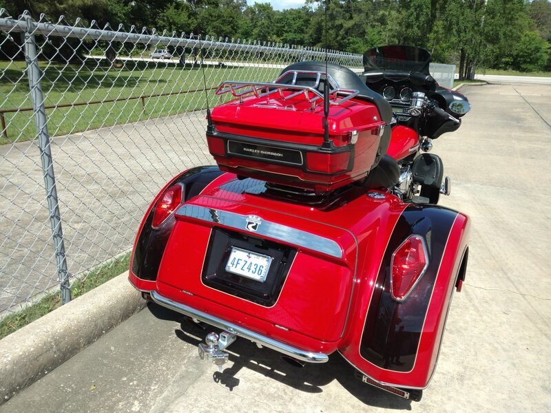

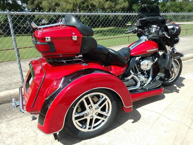

Roadsmith always does a real good job on their paint work, both in color match and the quality of the finish and pinstriping. The paint looks red and black in the pictures, but it is not. The bright red is Harley's Ember Red Sunglo and the contrasting dark color is Merlot Sunglo and it really pops in the sunlight. This is a beautiful trike and rides as good as it looks. We installed one of our 9 degree (+5) billet rake kits to help with ease of steering, its a must have as far as I'm concerned. Ron says he's coming to our Hill Country gathering, so he'll get a chance to put it through its paces and show it off.
Zook and his mechanic did an excellent job on the trike conversion. I'm completely satisfied with the build and quality of the conversion and love the way it handles on the road. Planning a trip to the Grand Canyon next month and can't wait to go on it. Love the extra 3 gallons of fuel just in case. Hope to see everyone in the Hill Country Ride as well.
