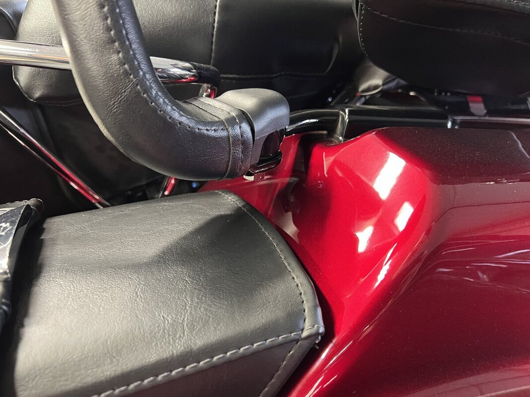

Hi guys,
My Tri Glide currently has the passenger armrests. I just purchased the Tri Glide saddlebags. I just eyeballed the potential setup and it looks tight to fit the bags under the armrest. Has anyone encountered this installation situation?

No issues on mine… yes, the clearance is close, but not any fitment issues.

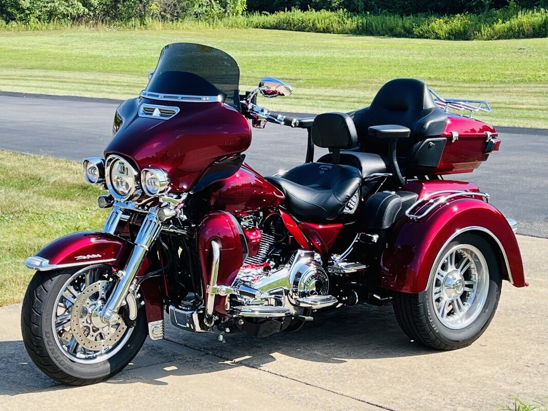

My TG had the HD “Saddlebags” already installed when I bought it, and then I installed the HD armrest kit last winter.

I think I’m going to use the template to sort of estimate the final position. My initial thoughts were that it was probably a tight fit but doable.
Your scoot looks great!!!

Thanks Sheriff!
I always customized all my bikes in the past and this TriGlide was no different. (It will most likely be the last one that I do a complete make over like I did, lol).

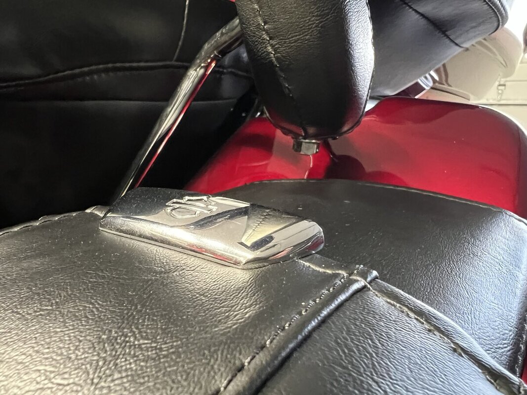

FYI: the top of the saddlebags are 3” from the top and still allows room to get in and under the armrests to clean.

Attached are 2 other pics I just took this morning for you to help show the clearance better between the saddlebags and armrest kit on mine:
