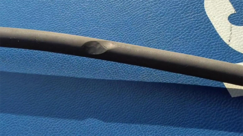

..............After admiring my work for a few minutes, I grabbed the nearly empty gas tank and eased it back onto the frame in its position.........AND THEN I noticed something's not right!
....the front jugs' new wire actually "majorly rubbed" the bottom of the gas tank at the welded seam! ....I tried relocating the wire - but no way to change the wires' path from the plug to the frame............this is the only way the front wire will go on....and as the wire travels from the plug to the frame = It will rub the gas tanks' bottom welded edge with enough pressure to wear a serious notch into the spark plug wire over time! ....I don't even want to think about what that could mean if it starts arc-ing on the tank!!!!!!
....I thought "Damn-it Harley!" ......only 2 spark plugs each for thousands of bikes and trikes and you won't even slant shape your expensive plug wire boots to fit the wires at a proper angle? (This was not a problem with the original plug wires)
.....anyway, I cut off the 2 straight sections of the old wires longer boots and slit them longwise and slid them over the 10MM Phat wire ....Then I zip tied them in the spot on the wire that would rub the tank......... Next, I zip tied the front jug wire to keep it from rubbing the tank welded seam............"What a bunch of crap trouble this was!"
.....With this job finished, I went to the net and did some research only to find many, many, many riders have had this same problem!!!!!
.........and so, I pass this on to my inexperienced brother rider "DUDES everywhere!" ..... If you change spark plug wires = Check that front cylinder spark plug wire for possible wear damage located at the bottom of the gas tank weld........this is where the wire may develop a deep wear notch if you aren't aware and fix it first!!!!!!
(NOTE: it does NOT take many miles to damage the wire at this spot if it is pressing on that tank weld seam)
......This pic was one I got off the net showing the problem if not addressed:
.......Just thought I'd pass it on to others!!!!

This issue is prevalent with the OEM set-up as well. Read a post some time ago about this and solved my problem by cutting a short piece of transparent tubing and slipping it over the front spark plug wire where it tends to rub on the tank. Problem solved......ThumbUp

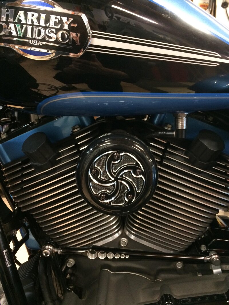

I read the thread on the HD Forum, there were a few questions, I can answer a couple. The coils fit in a rubber "grommet" that then fits into the finned housing, so the coils can wiggle around a little, and they are somewhat isolated from the direct engine vibration. There is no extra weight on the spark plug. The finned housings are held in place via threaded adapters that mount to the head bolts with set screws. Then another small screw goes down through the housing to hold it in place.
The wiring harness goes back and plugs in to the original wiring to the old coil. I didn't buy these for any special performance gains. I was thinking about new plug wires and saw these in a display case at a local independent shop. I first used Accel stuff about 46 years ago. He made me a super deal on the coils, they had been in his case for a while. I just looked on J&P Cycles, they want $267 if you are a club member. I think I paid about $150 for them. I like the look, she starts and runs, and no plug wires.
The only downside I can think of is you have to use a 3/32 allen wrench to loosen the 2 screws and lift the assembly off before you take out the plug. Takes an extra minute or 2...YMMV
Oh yeah. I replace the plugs at 10K or so, there's only 2, and they don't cost much...it's not like a guy would save big money leaving them in...
I've had the coil packs on my TRI for about 3 years now. I like them alot also. I put them on when a plug wire went bad the same way. By the way those set screws are a bit of a pain, but you don't need to remove them often.
