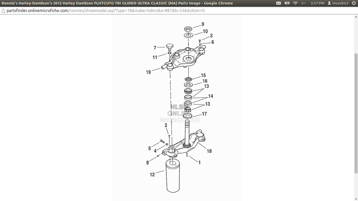

My previous 2 Harley's I used to preform my own maintenance. On my '12 TriGlide there was a tray under the bottom of the steering bearing that would catch any excess grease that seeped out of the bearings.
So that excuse of it dripping on the fender is BS. I never had that problem.

No tray in the parts explosion, I think you're talking about the bottom part of the triple tree. Its kind of indented on the top. I can tell you for a fact the dripping grease is not BS, I clean it off the back side of the fender of my 06 Ultra every time I was it, which seems to flush it out of the dished area of the bottom triple tree. You must of been blessed not to have a grease film on the back side of your front fender, or you didn't wash your bike with water. The recommended grease from Harley is a known seeper in real hot weather.
