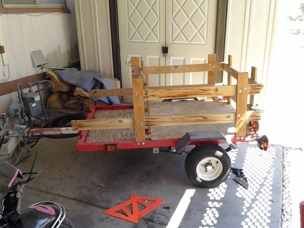

I have used my HF trailer for 3 years now, dont even know its there so when i get the trike back i dont think it will be any different. I didnt pull the spriings at all im a bit heavy around 300lbs empty. I did make my own axle and used harley wheels.
