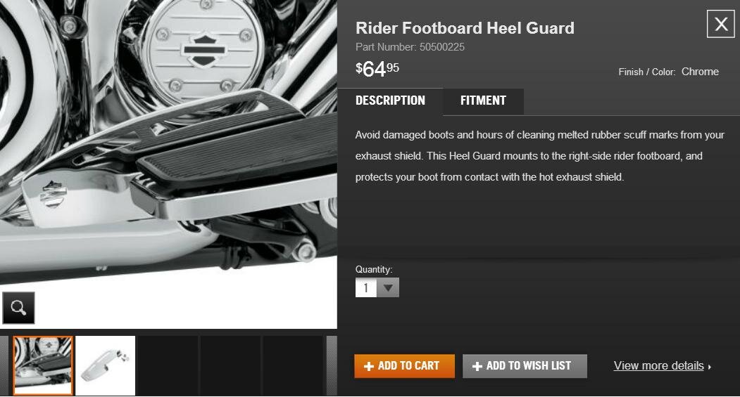

Well, I can say I am a happy camper, took the new trike on a 2235 mile trip and had absolutely no issues. Only had one problem and it was totally my fault, placed the heel of my boot against the heat shield of the front cylinder and left a mess on it. Will get it cleaned up after we get back from a weekend trip. I know on the HD forum there was a guy that sold a kit to move the driver boards out, does anyone have the contact info. I accidently deleted my link to the boards..

DK Customs sells such a kit I just installed one on my trike. They are a forum sponsor here great people.
1" floor board extenders plus I use the H-D boot shield. Goof-Off will take the rubber off the pipe.

Thanks guys. I tried some charcoal lighter this morning and it did take some off. It will take a while but I will get it off. Really burnt the boot pretty good, too. Will order a set of the 1 inch extenders from someone. I can't find a link for DK but also found some on ebay, etc.

I used 0000 steel wool....rub lightly, no rubber and no marks
I have the DK Customs footboard extension. Hard to believe the difference an inch makes. Almost wish it was 2, but I think that much would be silly looking.
