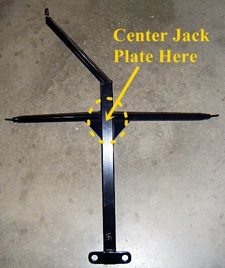

Have Hannigan BMW K1600 trike and am about to install ceramic coated Remus exhaust headers. It would make the install easier if I am able to jack up trike to work on it. Will the framework for the trailer hitch support the back end to get the tires up on blocks? The Jack has a 9x15 inch flat surface. Or is there a better way? :confused::confused::confused:

Keith,
Thanks for the question and contact ThumbUp
Still loving that Candy Antares Red !
No issue at all jacking the Trike rear up as you desire. Place the center of the jack-plate directly under where the rearward-most 2 left & right attachment supports of the Hitch come into the Receiver Tube and lift away (see attached Pic).
*see all notes below as well
Hope this answers your question.
Awesome Day to you!
FYI to All,,,, Any Hannigan Trike equipped with a HMS Trailer Hitch can be jacked in the same manner. Of course the Hitches look and are designed/constructed a little differently but all share the same basic design. Center the Jack-point directly under the Hitch at the junction of the 2 Frame-mounted supports where they join the Receiver Tube and lift (as depicted above).
Also, given the In-line Drive-Shaft & Offset Differential design of the HMS Trike, it is suggested that someone assist in the Jacking Process by holding and stabilizing the long-Axle side of the Trike when raising or lowering the Unit. Have someone simply stand on the long-side at the Wheel center and place their hands under the center of the Fender-well to prevent tilt/lean/tipping. It doesn't take much strength or effort if done from start to finish of the raising and lowering process.
Obviously as with any such situation and Vehicle, once the desired height is achieved, Jack-Stands are HIGHLY suggested.
