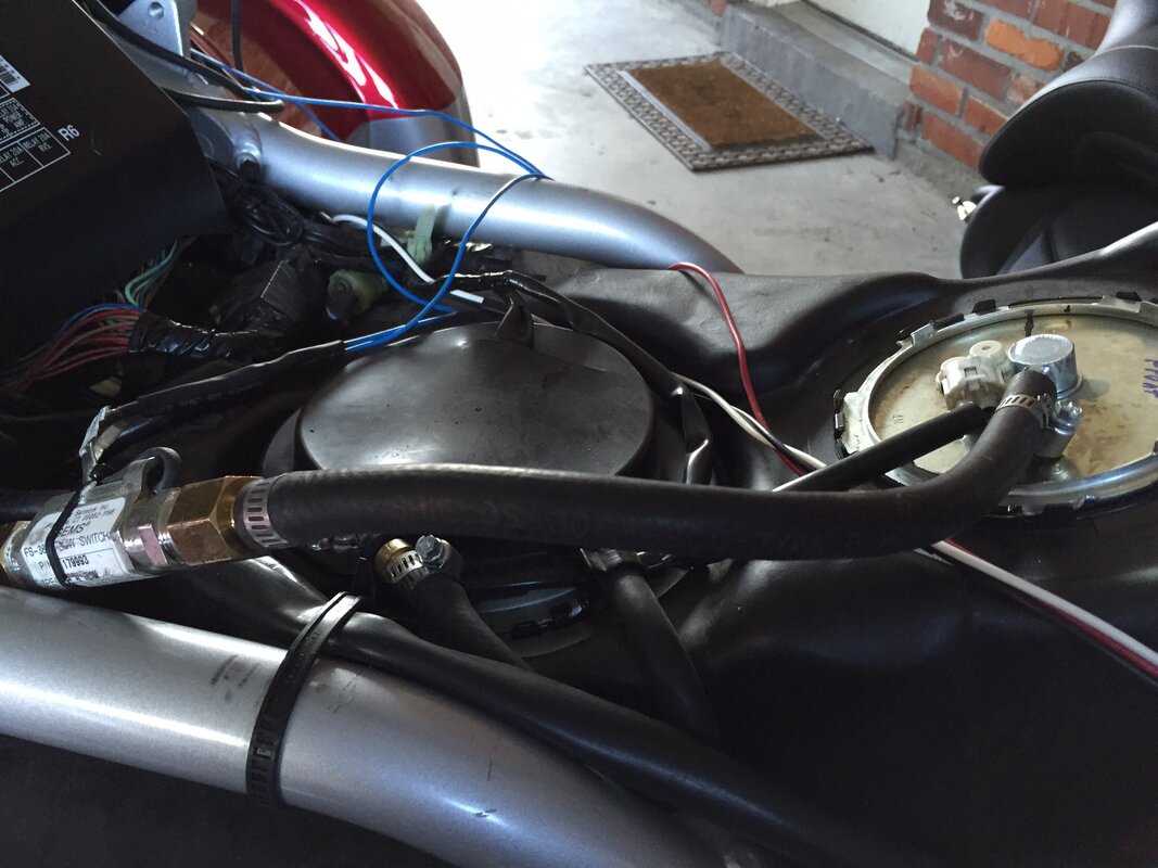

Hannigan doesn't like to fool around with the factory fuel tank, but this mod works like a charm. I added a 6 minute timer to mine so when it's done transferring the pump automatically shuts off so the pump won't run dry if you forget to flip the switch off.

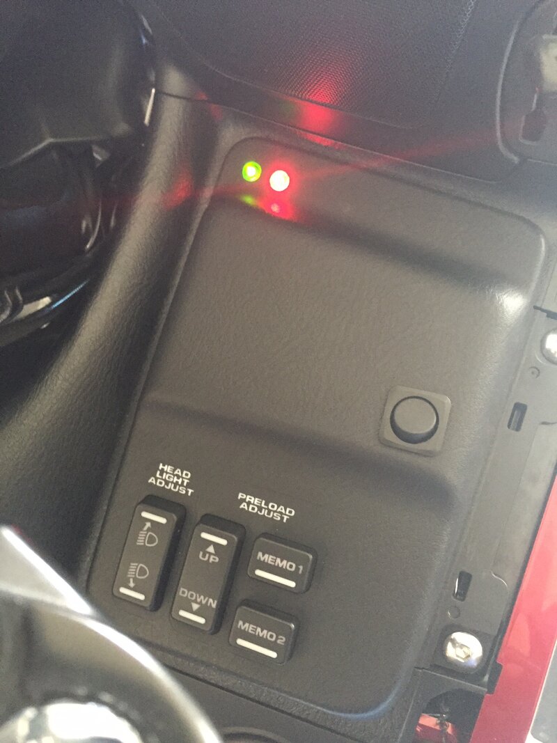

Purchased and installed the Roadsmith fitting along with a GEMS .5 GPM flow switch that I bought on Ebay. Flow switch is made with a stainless steel body with a hermetically sealed reed switch, which makes it safe for use in gasoline service, which is very important!! Tested and works perfect. I will hook the flow switch to a LED light next to the Aux Fuel Pump switch. This will allow me to know when fuel is being transferred. Don't want to run the pump dry.
Contact Roadsmith parts at The Trike Shop, phone number is 800-331-0705. The part number is A-200-40 Rev A. There are also two washers and a nyloc nut. Total cost with shipping was $38.
Aux Fuel Transfer
The Aux Fuel Pump switch is below lights to the right.
I added two 12VDC LED's. Red light means pump is running. Green light means fuel is flowing. Pic to the left is both lights on, Pic to right is red light only. Tested and works perfect!!
