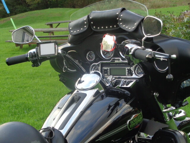

I installed 10" KST Mayhem Bagger bars on my 2015 Triglide and couldn't be happier. Just enough height to straighten up back and shoulders and not look obnoxious. They sit level with the top of the fairing and the best part is back and shoulder pain is gone!

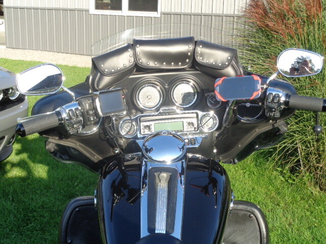

View attachment 82787View attachment 82788View attachment 82789

I'm 5'8" tall medium build I wear a Medium sized shirt I really don't know sleeve length for sure my guess is close to 32. Also inseam is 30" . What is nice about the 2+2 Wide sweepers is the added leverage they are wider than OEM I think close to 4 inches wider I love them. Good luck on your choice handlebars are a big part of a comfortable ride and an expensive choice no matter how you look at it. What works for one may not work for another.:good: ride safe Fred

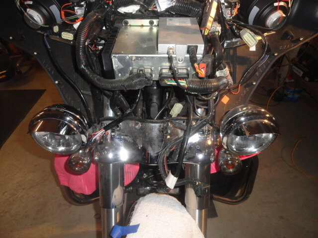

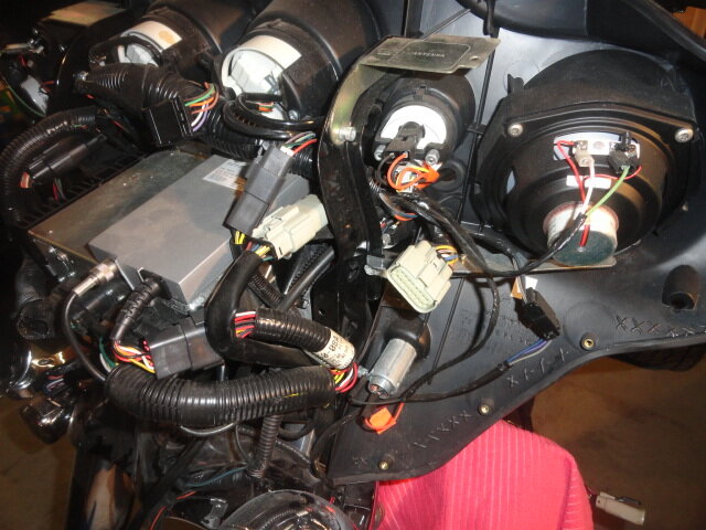

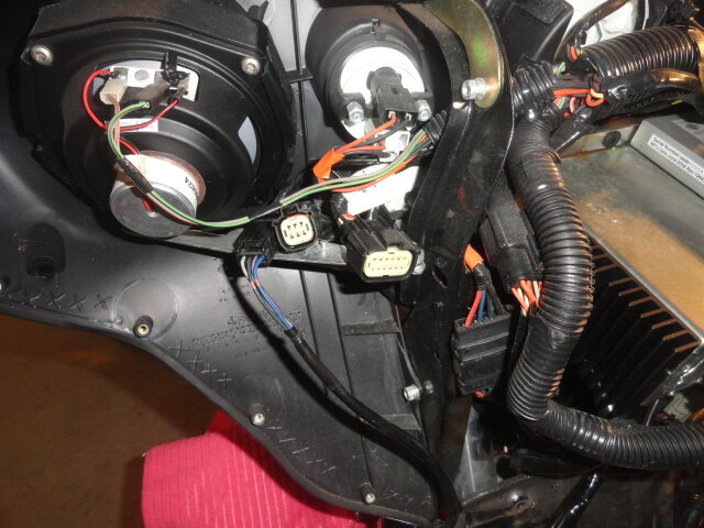

I have no idea how much experience you have with wrenching on your ride. With a shop manual it was my first time doing any work on a motorcycle. I didn't run the wires in the bars or anything fancy. 09' Only thing needed was the clutch cable had to be switched for a longer one +3 will do it however a +6 was so much nicer. If you have a hyd. clutch I'm not sure of any changes needed there. The wiring is plenty long inside the faring to adjust for the added length I'm all but certain on that. Good luck take your time be patient and it will go well, be sure to sit on the seat a adjust them for you before you button up the dash. They are going to feel strange at first because of the different grip angle. These bars make a world of difference ride on the long term :good: Travel safe Fred

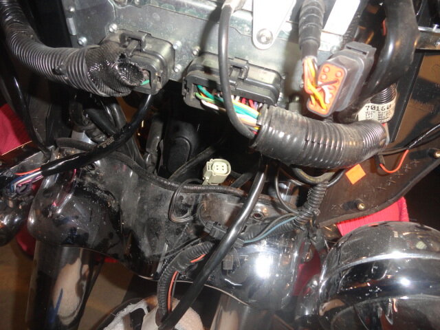

Mark, I think you can do it, I’m not much of a mechanic, but it was a simple install. Ran the wires external and did not need any extensions, if something feels a little tight check the zip ties, you may be able to loosen it up by rerouting a little bit. There are all kinds of videos on you tube, watch a few before you get started. It also helps if you have an iPad or something you can take to the garage with you to reference. The only money I spent was what the bars cost.
