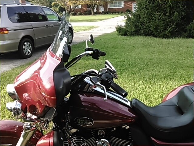

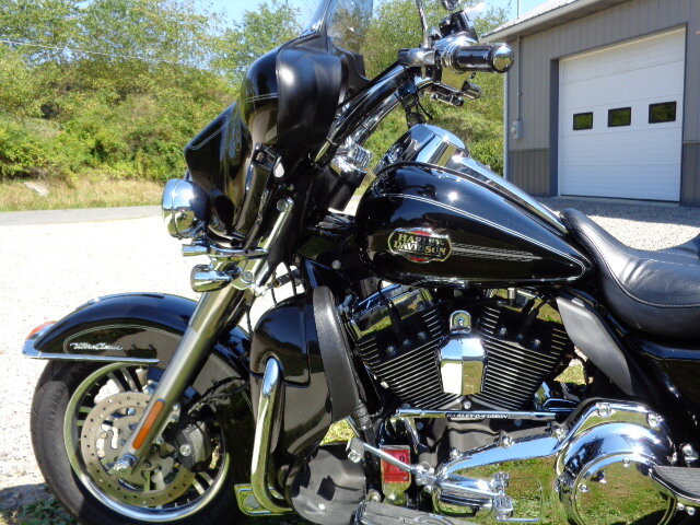

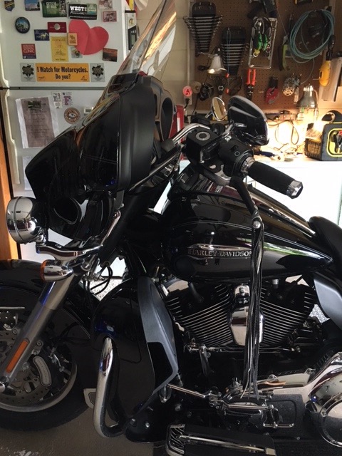

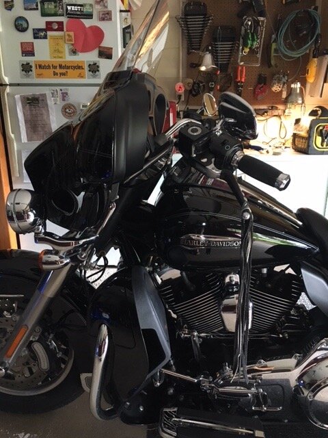

Here is a pic of the stock bars from the side....

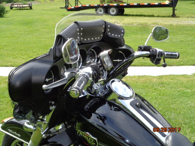

....and here is one of the Batwing Reach Bars from the side....
I hope this helps :Santa:

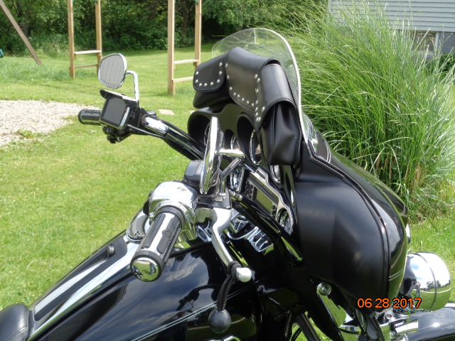

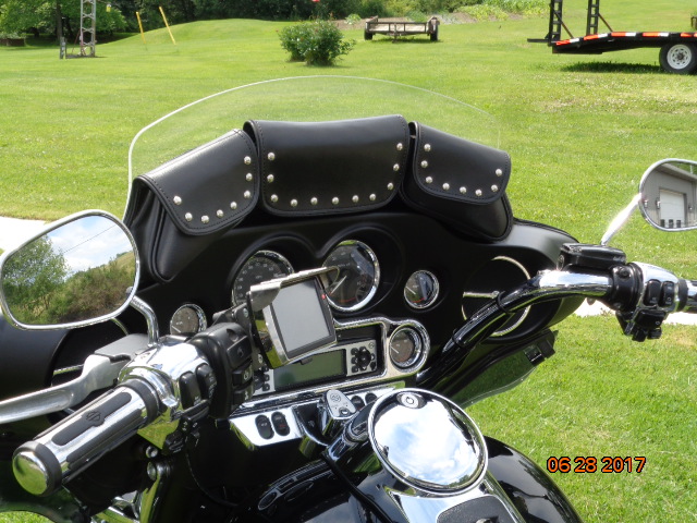

2+2 wide sweepers
These resolved my back and neck aches may not work for you but they really are nice for me. 2" up and 2" back and close to 4" wider like power steering. DSC00124.JPGDSC00132.JPGDSC00137.JPGDSC00268.JPGDSC00552.JPGDSC00554.JPG

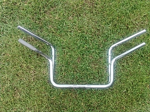

These are the narrow ones, about the same width as the ones I took off. I'm 5'8" with a 29" inseam.
I've since rotated them up, more toward the windshield.

Sweepers are 31.94" wide OEM are less than 30" 2+2 is 2" higher and 2" back You can see how mine are,DSC00553.JPGDSC00556.JPG I have them pushed just about as far forward as the inner faring will allow. I have a tank lift and used the sweepers because they are convex in design to make sure they cleared the tank.
