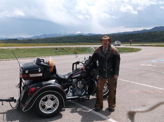

Yep that is a problem with all trikes. I have a local intersection with many coats of white paint for crosswalks and stop bars. When I make a right turn here it is a real bitch. Must go slow. I try to avoid this intersection if I can. The problem is worse with SA but happens with Independent also to a lesser degree.
