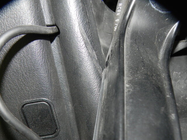

I was told that if installed the bars in their new position would hit or catch on some plastic parts and therefore create a hazardous condition.
What you were told can be very true. Various combinations of easy steer kits and various risers can cause interference with the bars rubbing on the meter panel. In the aftermarket world, everything that is added to a GL1800 should be considered an experiment until tested thoroughly. It would be my guess that the installer who told you that found that out after installing a set on your Wing, and then removed them to avoid liability.
I've seen 2 sets do it and neither customer was aware of his bars hitting until I pointed it out. In both cases my recommendation was to remove them, after all ... riders should be in full control of their scoot at all times and under all conditions.

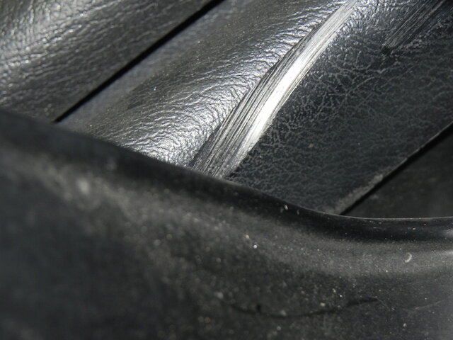

Here are pictures of how risers with easy-steer can cause interference.
View attachment 46681View attachment 46682View attachment 46683
If that trike had damage like that after the risers were installed I wonder how they even managing to turn corners before the install!!! The risers when properly installed will bring the bars far about that damage area. Someone screwed up somewhere. Infact, I bet the damage was there before the risers were installed... :xszpv: :xszpv:
Greg this one sure did interfere. Thanks for sending the series of pictures. Do you remember the type of risers and the degree of rake? I am using MBL with a 4.5 degree rake.
Sorry, I don't remember. Not only is there various rake kits, but there are probably at least 6-8 different risers.

Sunman that is my experience as well, which is the same as Gold Rush's. I suppose the degree of rake has something to do with the damage shown in the pictures above. My risers are working for me just fine. Much more comfortable. Thanks to all who helped me come to this conclusion.

Risers also serve as set backs which make riding much easier on a Trike. A few minor scratches on the side of the plastic are well worth the benefits on risers/set backs.
