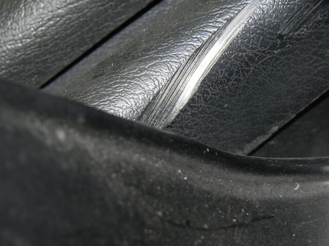

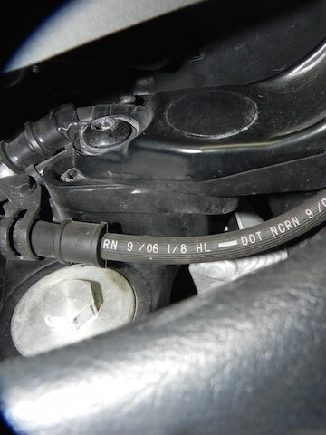

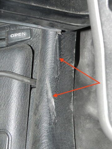

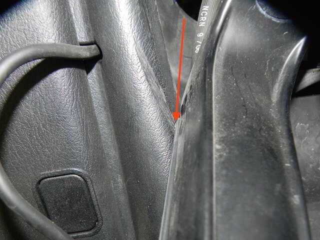

Make sure yours don't do this. This one came in today. He too has risers, and it appears that his risers are causing the cable/hose covers on the underside of his handle bars to rub his front shelter assembly on each side. My advise to him ... never, under any circumstances, should there be any interference when turning, throttling, or braking. He needs full control of his m/c at all times.
I've not inspected this m/c yet; however, at first glance it does appears the following parts are OEM; triple-tree, handle bars, under-bar covers.
I've never seen any risers do this till now. Some risers are adjustable. Possibly with an adjustment will fix this situation.
