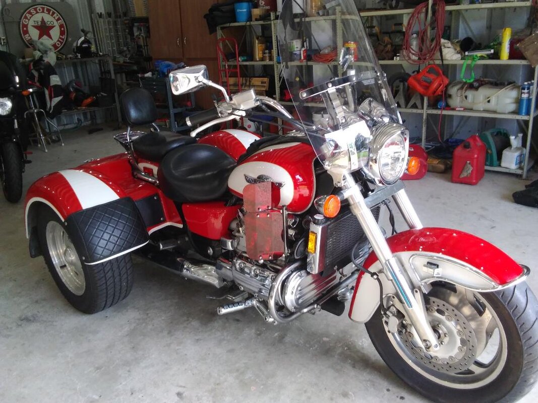

I just got done rebuilding the carbs and getting the Valk ready for the Roadsmith kit to arrive. Not as hard as I thought it might be. Cleanliness and patience are the keys. I am looking forward to getting the kit and triking this thing.:cool:
Looks good. Almost bought a black Valkyrie trike. Was looking at a dealership and was $150 apart on price. He wouldn't budge and me neither. So I bought this one $1200.00 cheaper.
