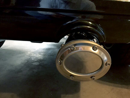

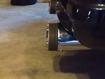

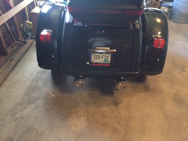

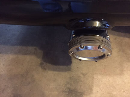

Here's some photos I took of the E-Series slipons on my TriGlide
This is a view from the back.
Close up of the exhaust pipe
Closer view showing how it fits with the indent on the rear
View from the side to show how far it sticks out.
Thank You
GoSlo, thanks for posting the pics. I am probably going to order a set from FuelMoto. The one I am running on my 07 Road Glide is a Supertrapp Supermeg 2 into 1 and it has a slash up which I like. I wish the E's came with a slash choice. I know they have the optional slash end caps, but a hundred bucks each is ridiculous. I really don't like the loudness of the 3 1/2 inch classics I am running. I have a moderate hearing loss and use hearing aids. I have road with ear plugs for the last 6 years or so, and I do not won't to lose anymore hearing. Thanks again for the pics.
