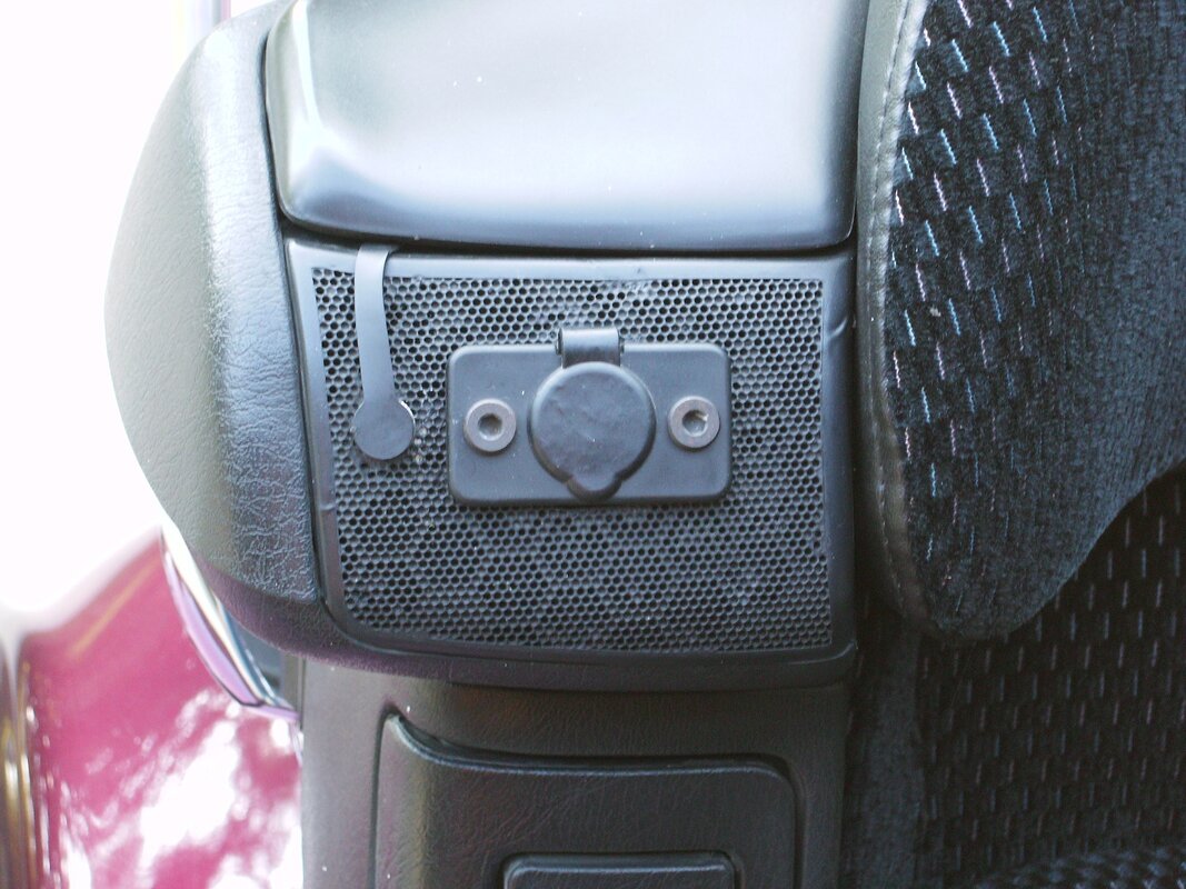

From 2001 (the GW1800's first year) to 2005 rear speakers were optional on the Wing. Honda sold a set, and there were upgrade aftermarket units from Polk, Big Bike Parts and many others. We have an '04, and we have helmet speakers with our intercoms, so we don't need speakers. I used fiberglass mat and black ABS cement to line the inside of the grill to make it water resistant, and installed a cigarette lighter style power outlet and a coax power port for the Admiral's heated jacket liner.
