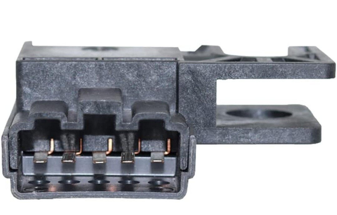

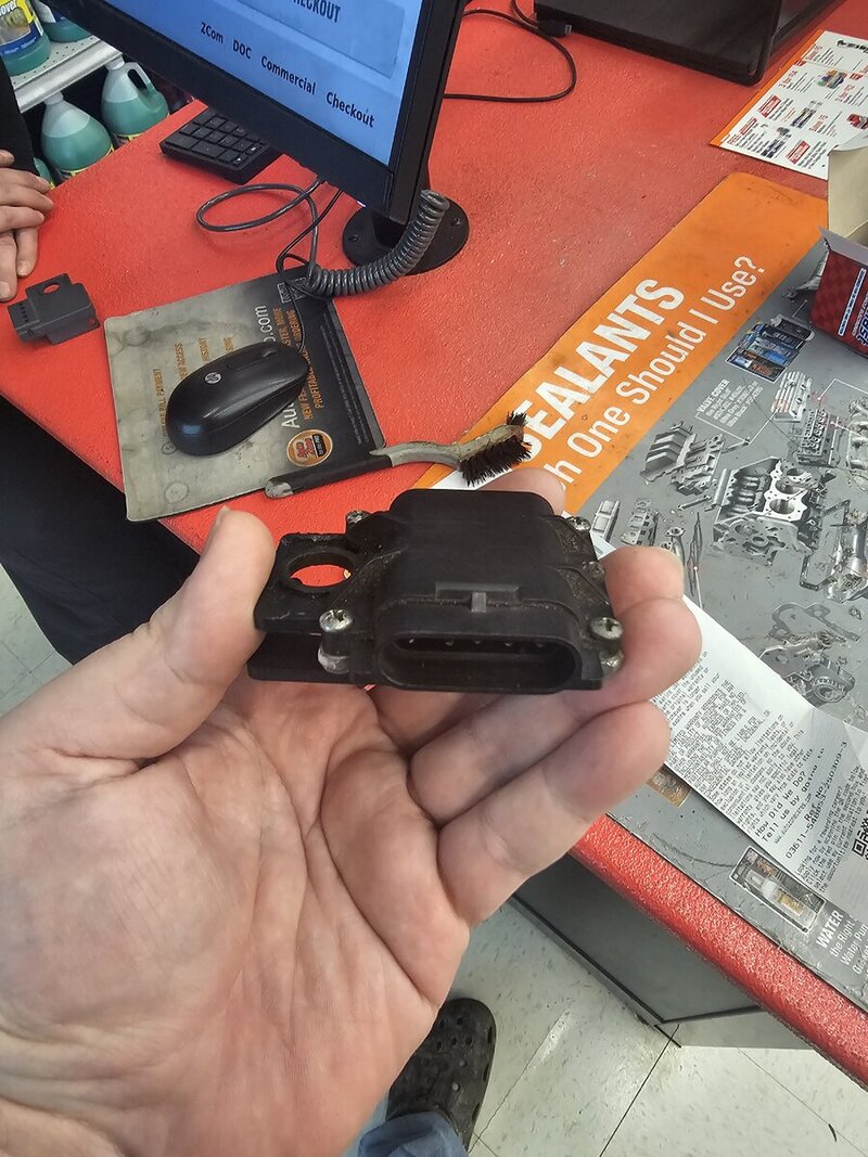

Im glad that you asked that question, and thought I had updated after determining that we in fact did not have brake lights. I am on a fixed income that doesn't cover much so have had to take it a bite at a time.
I've worked on this in two stages. The blue switch that is pressed by the rod from the brake peddle was replaced a month or 2 ago, and had clearly failed (it was stuck in the position where it is pressed in and not moving when the rod moved off of it) but its replacement didn't give lights or allow it to pass the cc self test.
So I finally got a replacement switch to try in it...found the part number from a part list someone had posted in the stallion trike Facebook group, and to my great surprise (not) it was the same one used in all of the Rangers, and pretty much every ford for that matter. Problem is that when I took the old one off to swap it, the connector is not right. Similar build though.
I was told that the car mechanic that "fixed" it up for them had ended up causing a few new issues, so I'm not sure if the old one is stock and I just got the wrong part (in which case if someone could direct me to the right one I'd appreciate it) or if the guy that "fixed" it rewired it to match something he had on hand and the one I ordered was what it was meant to be and I need to grab a connector from a junkyard. Or if I am an idiot and somehow misunderstood where the brake switch was supposed to be and this is an unrelated part that was attached to the brake booster (I don't think this is the case, but cannot 100% rule it out, worked on computers a lot...vehicles are a new trick)
In the included pictures, the stock photoScreenshot_20250319_222844_Amazon Shopping~2.jpg is the same as the one I bought from autozone, while the one in my hand
is the one that I removed from the trike. Still 5 pins with about the same spacing, but different plug shape.
Asked several folks at multiple part stores if they had a clue where to try and find the replacement of what I pulled off with no luck.
Unfortunately no part numbers or identifiable markings on the old one so kinda stuck.
Had forgotten that reaching out to motorbike was an option so will attempt that during business hours, but thought I'd also reach out to the hivemind and see what yall could tell me.
the switch in your hand is a replacement switch made by tbms. comes with switch and wire harness which you splice into stallion wiring harness. the other switch is a stock switch used on a lot of fords, if you use the stock switch you will have to replace the plug wiring harness with original and splice back into system
Dragon
Dragon
I appreciate the reply. So the stock switch should work if I grab the harness for it from the junkyard? Given that from what i have heard the custom parts are getting harder to come by, it may be better to just rewire it.
I assume it's not far different from house electrical in terms of splice and heatshrink to protect it? New to automotive, but familiar with tech and house electrical so forgive me if it is a dumb question. My understanding would be snip existing 5 wires and rewire them to the new plug wires, add solder and shrink.
Regardless, im going to reach out today to see what tbms/motor trike says and if they can help.
To update, I did reach out to MotorTrike. They said they have been out of the part for a while but gave me a number to a mechanic that might have one...and the number they gave has been disconnected, so looks like I'm going to a junkyard and figuring it out!

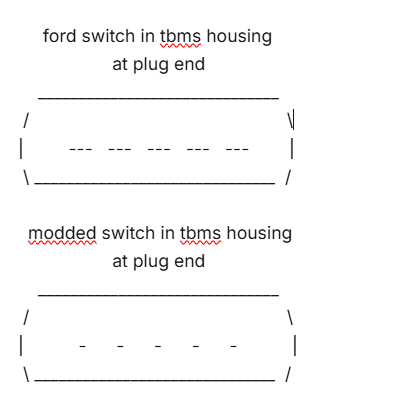

so i popped the bolts and had a look and there was plenty of rust and corrossion present. had some sensor cleaner from a vvt replacement on the Cage. I removed each blade from the assembly and applied liberal amounts to each buffing with an old tshirt, realizing halfway through that the music in the garage tasted a bit too purple and moving outside to finish. at the end, I said my appropriate prayers to Murphy that his law may not impact this expiriment, sprayed the casing and wiped it for good measure, and reassembled.
now we have brakelights, cruise control and the park shiftlock works (we have been having to open the hood to release from park...referred to it as the security system. laugh-crys) I wish id openned it earlier, id have realised it was analogue and easily fixed it.
additional note, while i had both in front of me i opened the stock style one. while the profile of the plug is far different, the blades seem identical in shape and placement, except for one thing. the pin looks to be too wide for the tbms connector.
As mine didn't end up needing to be replaced this is conjecture, but i believe that if one were to use a grinder, Dremel, etc to shave the pins it would work within the tbms housing. I wish id taken sideby side photos of the casings to show what I mean, but alas I did not.
(crude diagram to follow of what I mean)
had to screenshot as TT stripped my spacing and formatting and i havent the brain cells to figure out how to fix it 1743576614843.png
again, this is conjecture, as mine was fixed without having to use the new one as a donor but it was clearly mechanical and not digital and to my mind I saw nothing to suggest it wouldn't work well...that said, i have learned more car repair since my partner brought Rose into my life than i was aware existed, so wanted input on if there is anything i'm missing here before I mention that part in the parts and service thread since I didnt actually do it preferring to refund the part since all was working and the new one unused.. that covered the cost of the relays in the update below.
