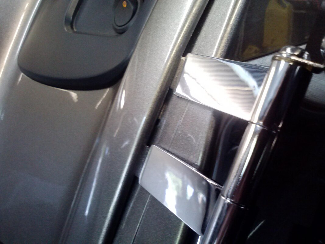

Received and partially installed B52-865L wind deflectors. Your description states fitment for all years of GL1800, other sites state 2012 & newer. On my 2003 Gl1800 the upper arm bolt can not be installed even thou the holes line up. No way to get behind the hole to attach the washer & nut, not sufficient space. Seems like a blind hole which would need an insert of sorts to secure the bolt. I used a push rived similar to those used in the pockets of GL1800's but it is not a solid secure fit. The bottom arm is secure with the existing bolt. Please forward this to the appropriate department and if possible have them respond to me.Thanks, Ron Hochhauser

Ron, I don't see a fix for your situation other then to return the deflectors to Big Bike Parts for a refund. It's clear from the installation instructions this unit is designed to go on 2012 and newer GL1800s. You'll probably have to give them a call and get an RA. Sorry you ran into the issue. I've found it's a good idea to read the install directions when they make them available. It has saved me from this same situation a couple times.

Gold Rush, Thanks for the interest. They're on & I like them. I just need to better secure the top arm. Thanks. I'll post my solution when I find a better solution. Their web site states 2001 > 2012 fitment.

Since you are determined to keep these deflectors you might look into some sort of blind nut arrangement. I remember several years ago I stripped out one of the side bolt nut plates on my '01 GL1800. I JB Welded an actual nut in and it worked great... I'd bet some version of a spring clip nut plate would do the job for you.

I use these on lots of things, the hole will have to be larger, no lube on the rubber, but place a very small amount of silicone lube on the bolt so it can be removed later easier..... Lowes in various sizes ..... or as goldrush said a small amount of JB Weld on the rubber and push onto tuperware til secure, no larger hole needed if you can get to the area.... always use the brass or S/S ones so they can be removed. Have always worked for me....

Yep, I figured that out. Plus the video shows an additional piece attached to the bottom right side trim? Fit is good on my 2003 except trying to attach the top arm, not enough room to get behind with a washer/nut. I'm working on that. What year is yours? :Dorag:

So far they're secure. Did a 300 mile round trip and still secure. Let me know how your installation goes. :Dorag:
Without actualy knowing your entire situation and my bike is a 2012 (below the controls also hard to get under. Maybe this would work for you. I purchased an off brand from a family over in Lakeland Florida that actually designs and fabricates them themselves (great product too) To install one of the brackets it came with very short "Molly Anchors" the directions were to drill a whole for the anchor and attach the bracket using them. worked great. As long as you have the room underneath you should be fine.
