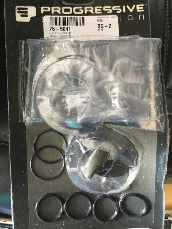

What my Lehman has, but I'm not at all sure about MTs, but the 416s are no longer made, but as recent as a couple months ago I bought a seal set for mine to "have on hand". Got them off Amazon. # 76-5041 … though they also have the number 30-5041 on the package?
I know package looks rough, I have another to compare, everything is in there, looks like the blister wrap just relaxed. The blister wrap is not broken, so I know they are good. Honda shocks on the 1200 used the same seals, or Progressive used Honda seals, I forget which. The Progressive 416s had stiffer springs in them though.
