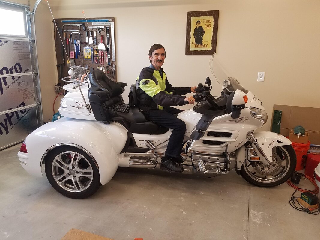

Finally got the CSC Trike!
OK, she's finally done and I picked her up last Friday. Put 75 miles on her to get her home from the dealer/installer.
Like everything about her except the increased exhaust noise. Gonna post up a new thread to discuss that.
In the meantime I'll post up a picture. (Fender bras not yet installed. CSC says let the paint cure for 90 days first.)
