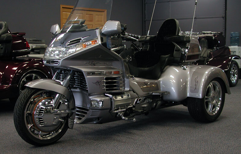

dirtdobber - NOPE / RE-read the 1800 system pumps from the aux. and fills the main tank as you state CORRECT ----- the 1500 system is different, 3 position switch that works different / Flipped to top (up) position the Honda Main Tank fuel pump is powered and supplies fuel / Flipped to the center position it disables both fuel pumps power as an anti theft deterent / Flipped to the (down) position the fuel pump on the aux. tank is powered to supply fuel to the engine. So it should not be a transfer pump if installed as designed!!! The 1500 Aux. tank has a filler neck as shown in the photo so neither system is gravity fed.
