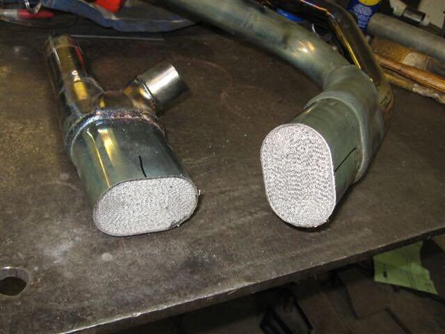

I'm amazed at how restrictive the catalytic converter looks to be. Anybody know what material it is made out of?

Ceramic core plated with platinum. That's why replacement catalytic converters cost so much (other than the normal gouging placed on such items) - platinum is precious.
They flow a lot better than people think. A pretty reputable builder and tuner managed 119hp and 132ft/lbs or torque through a factory head pipe and rush slipon's installed on a 124" S&S HC engine. The cat didn't hurt the torque much at all, it did cost about around 15 hp.
