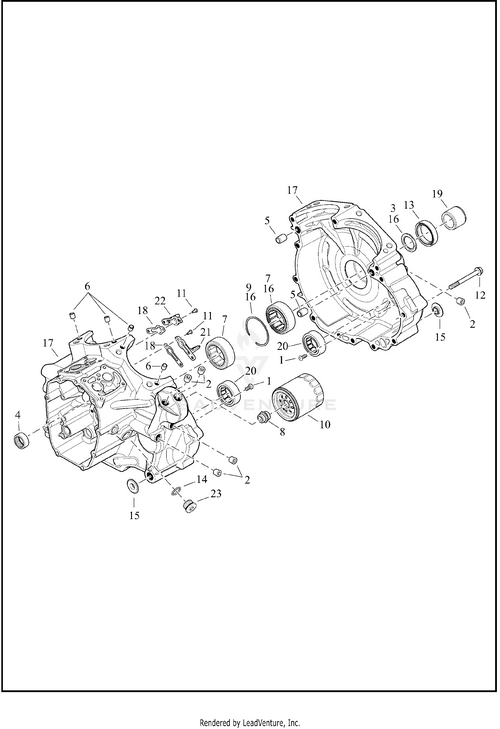

Just ordered a Feuling short sump plug and I am unsure where to install it on a 2017 107 CI M8 trike. Does anyone know if it is the same location as a 2019 trike?
Or if anyone has already done it , can you please send pictures of the location. Also is the factory plug red in color?
Sorry if I seem stupid :dunce: , but the picture in the factory owners manual of the engine and trans drain plugs has me confused. I keep wondering if the sump plug is plug #3 , the one the manual says not to remove.
Thanks in advance.
It is NOT the plug in the oil pan, it is in the crankcase
Look under the RS of engine, # 23 in diagram

Thank you Jack. Now I feel like a complete idiot. I should have figured the difference between the engine case and the oil pan.
Now the fun is going to be lying on the ground trying to get at the plug.

You may want to use a heat gun to help get that plug out, go slow removing it, if it does not go easy use more heat, that plug could crack the case coming out
Same going back in, it does not have to be super tight to seal
