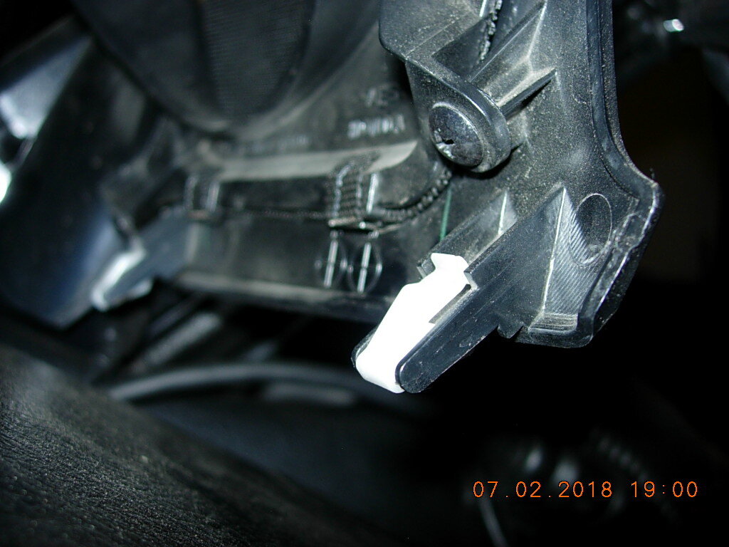

I ride a 2016 GL 1800 Goldwing trike. Need to replace the left front speaker cover. Does the cover snap on and off or is it held on with screws?
Any and all help is greatly appreciated.
Thank you.
I have a 2017 which should be the same. I just pulled the front panel enough to see the backside. Picture shows one screw and one grill tab. As far as I can tell, there are at least 4 phillip screws and at least 6 grill tabs. To get the panel off, just pull up near the bottom of the key area. You have to disconnect a large connector in the middle and the two tweeter connectors in order to remove this panel.
