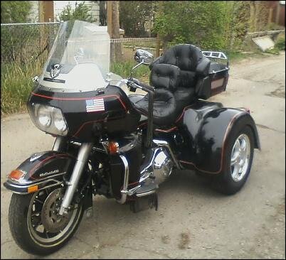

I have found with my old tour glide that running 40 (the max inflation recommendation makes it easier to steer and the wind doesn't blow me around so bad when it catches my fairing. I run a rear tire the exact same size as the original front tire (turned backward rotation? for a couple reasons.
The rear tire is made of much harder rubber than a front tire and there is not so much side flex. ( I don't need side flex to corner) I need a good gripping tire that will wear for many, many more miles than a front tire.
I am running a Dunlop elite and it has around 18,000 miles with no cupping and has just a whole lot more miles left in it.

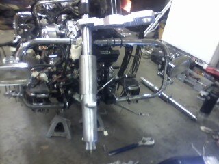

When I rebuilt my front end last fall I put in some heavier progressive springs (relatively inexpensive) and it sure made a difference in the ride. I also kept the anti-dive system when I converted so I also have some air pressure working in my favor.
I run about 24-26 lbs. rear

If it does have progressives. They will be tossed immediately and the OEM springs put back in.
I should also mention I have a fork brace and no handling issues at all.
Im just used to a front end that has an actual honest 3+ inches of real travel.
This bike has no more then 1.5 inches of dampening UNLOADED. Drop the front end and its not even an inch of actual movement in the fork legs.
