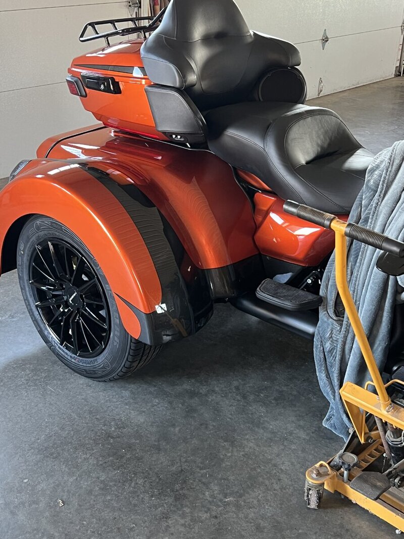

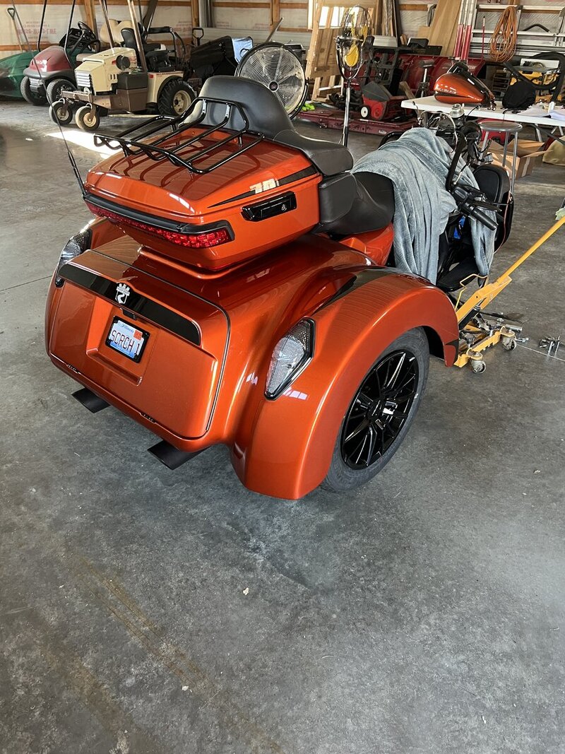

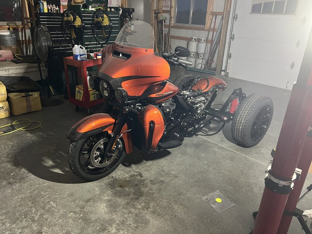

Between farming, dealing with my dad’s Estate, remodeling the old farmhouse, and our son getting married last weekend, it’s been a long project converting my 2020 Ultra Limited with a Roadsmith conversion kit. I go out to the shed after dark and work for an hour or two at a time and I’m at the installing mufflers stage, then the trike body.
After that, I’ve still got the rake kit to install and trying to think ahead.
The bike has 20k miles on it and the front forks have never been serviced. While I’ve got it apart, wondering if I ought to go ahead and at least change the oil in them.
Been reading bits and pieces here and there about different fork rebuild kits tuned for Trikes but I can’t find anything definitive for a recommendation.
Anyone done anything different with the forks when putting in a rake kit or have a specific fork oil to recommend?
BTW, this was one of my late nights last week. Since then, have the differential, driveshafts, wiring (including reverse) and hitch frame done. I’ll tell you, splicing in the 2 Bank Angle wires when you are colorblind with artificial light isn’t much fun.IMG_0462.jpegIMG_0461.jpeg

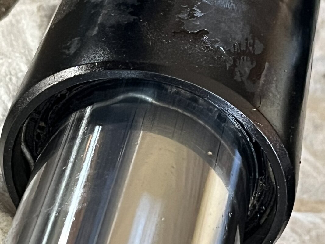

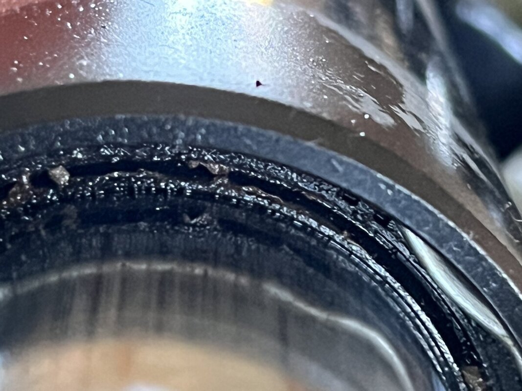

So I finished up the rear end and I’m taking the front end apart now to put the rake kit in. As I’m taking the left fork tube out, discover it’s all oily has a leaky seal. There is no dust seal and was sandy grit sitting on top of the seal.
I went to the HD dealer to get a couple repair kits to rebuild both and they say there is no dust seals on the Ultras. Seems odd to me, but that’s what the parts diagram shows. Waiting on another bottle of the Belray fork oil to show up before I start tearing them apart. IMG_0550.jpegIMG_0551.jpegIMG_0544.jpegIMG_0545.jpegIMG_0540.jpeg
