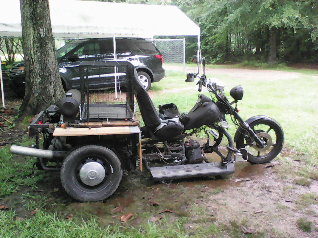

Hello, I get a vibration or shimmy or bounce in the front end sometime. It seems to have something to do with the road surface maybe. I have an '84 Yamaha 1000 front end. I've had the trike about 3 years, about 30k. It has not gotten better or worse. I'm wondering if this is common for vw's? Thanks for your time,IMG_20170606_082054.jpg

Well judging from that picture, your front forks don't look like they're using much more than a inch an half of travel. Vws set up like yours don't usually have much weight on the front wheel. I have xr 80 fork springs and never run more than 15 lbs of air in the front tire. My front tire is a 500x16. You should be using that inch and half travel just sitting down on the bike.
