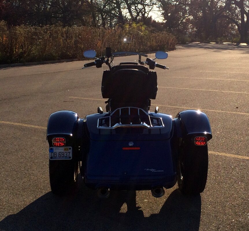

Yes, I have the 'Air Wing Light Kit' on my Air Wing Luggage Rack. I'd get a picture of the light installed for you but I just got back from putting it in winter storage. :Shrug:

I also did the LED tail lamps which IMO are much brighter than the stockers. I don't know how large this image will be when I post it, but when I blow it up on my computer you could just see the tiny red LED dots which make up the rack light. (Remember; the back of the bike is in shadows with just the running lights on).
I guess the Air-Wing Luggage Rack light is not all that powerful? That's good to know. Thanks!
No, I'm not saying that. What I am saying is that I don't have a very good picture of them in action. I imagine at night they perform quite well...

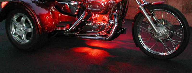

Good idea. I'm NOT promoting this web site, or this product but it worked for me. Here's my Lehman Raider (ex) trike -
http://www.customdynamics.com/step_lights.htm
* Extreme 5 LED Pod - Mounts on Side Surface - 5 LED Cluster - 22/45 Degree Angle *
I bought the black ones (to blend in with the frame color) cleaned and applied the double-sided tape as per instructions, then used black 6" Ny-ties to double-secure it so it would NOT fall off (nothing says "amateur" like an LED light hanging by a wire under a motorcycle)
Wire it to one of your brake light wires.
Here's a picture of the results ~ a red "pool" of light under my trike:
