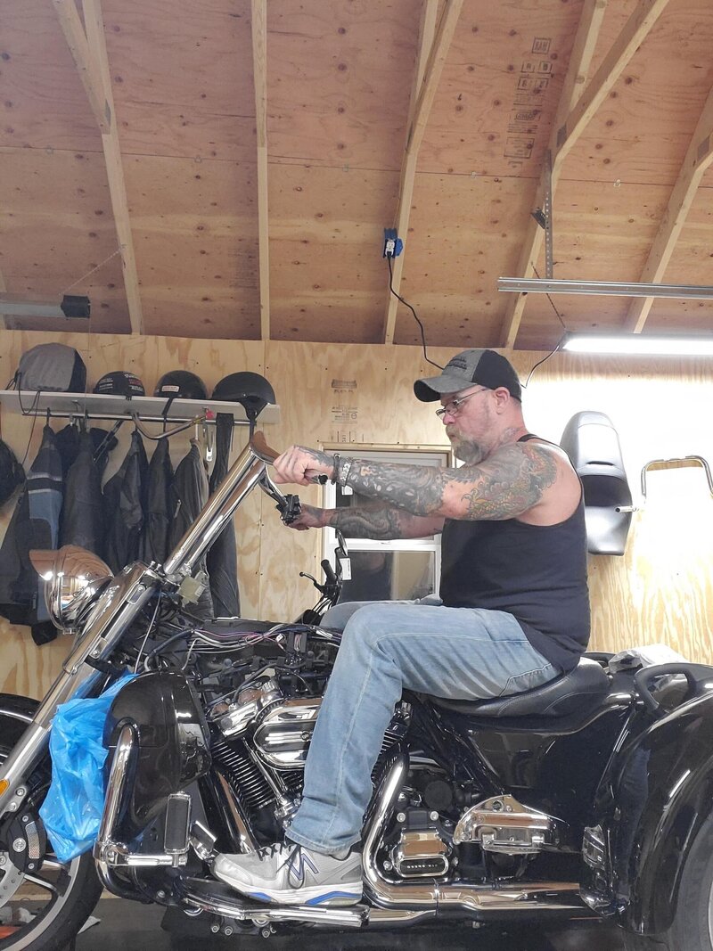

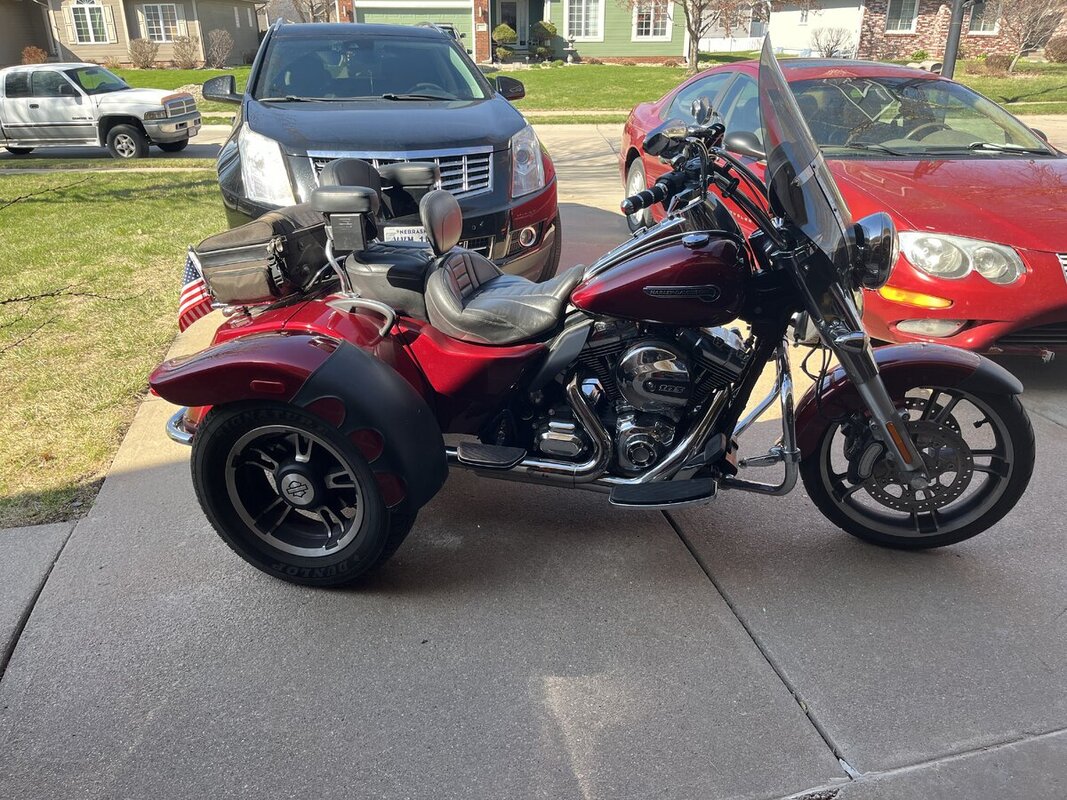

I’m also 5’ 8ā€ with arms that are a tad short.
These Klock Werks 2+2 narrow sweepers are only 2ā€ taller but they also pull-back 2ā€.
I think I have an average torso and with the new bars my arms are pretty much parallel with the ground with a little bend at the elbows.
Below are a before and after side view;
Stock 12ā€ bars:
Klock Werks 2+2 Narrow Sweepers installed:
Stock 12ā€ bars:
