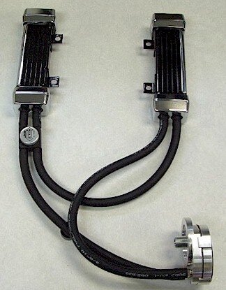

I have a 2015 freewheeler. I live in Vernon BC Canada. In the summer it gets pretty hot here ( 95 to 100 F ) so the oil gets up to around 260 with the stock cooler. I have added an extra jagg 10 row vertical cooler so the oil runs through both coolers. This has cooled my oil down to about 220. My question is will this harm my bike? Will it cause the oil pump to work harder an then fail? Will I lose oil pressure? ( my oil light goes out as soon as I start the Trike) Any response would help me good or bad
Thanks in advance for your comments
freewheeler and oil cooler
Plumbed in the same way except I don't have the shut off bypass for the ability to use only one cooler. My stock filter adapter has a thermostat so if the oil cools off to below 185 it will close by itself. I used the stock oil cleaner plus the jagg 10 row vertical. The oil hose from the stock oil filter adapter in to the stock oil cooler out the stock oil cooler into the jagg oil cooler, out the jagg oil cooler back to the stock oil filter adapter. That way it makes a complete circle Works good but don't know if the oil pressure from the oil pump is strong enough to pump through all those passages. Don't seem to be having any problems but just checking to see if anyone has done it and how it worked

What I am asking if any harm will come from running two oil coolers
gerald. Your answer is really easy. The lifters in the HD are kind of weak but get the job done. If hot at an idle your red oil pressure lite is off and you do not hear excessive lifter clatter then I would think you are good to go. If your oil pressure is to low the lifters let you know first.
If they are thermostatically controlled to a certain temp how could it hurt?
:Coffee: When the temp is low it doesn't pass any oil through, when the temp is high enough to open the thermostat it will flow through the cooler.
oil coolers
Thanks for the feed back. My lifters make no noise at all and the bike runs cooler
