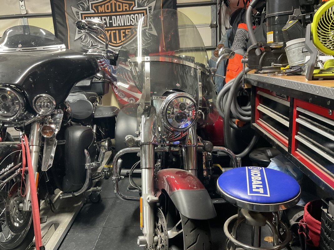

Below is a picture of a KlockWerks shield that I bought used for my 2016 Freewheeler that was on a 2019 Heritage.
The mounting hardware isn’t compatible so you’ll need to swap that out.
My KlockWerks windshield is rather tall so that probably isn’t the windshield you’re looking for however a windshield for a Heritage works on the Freewheeler.
