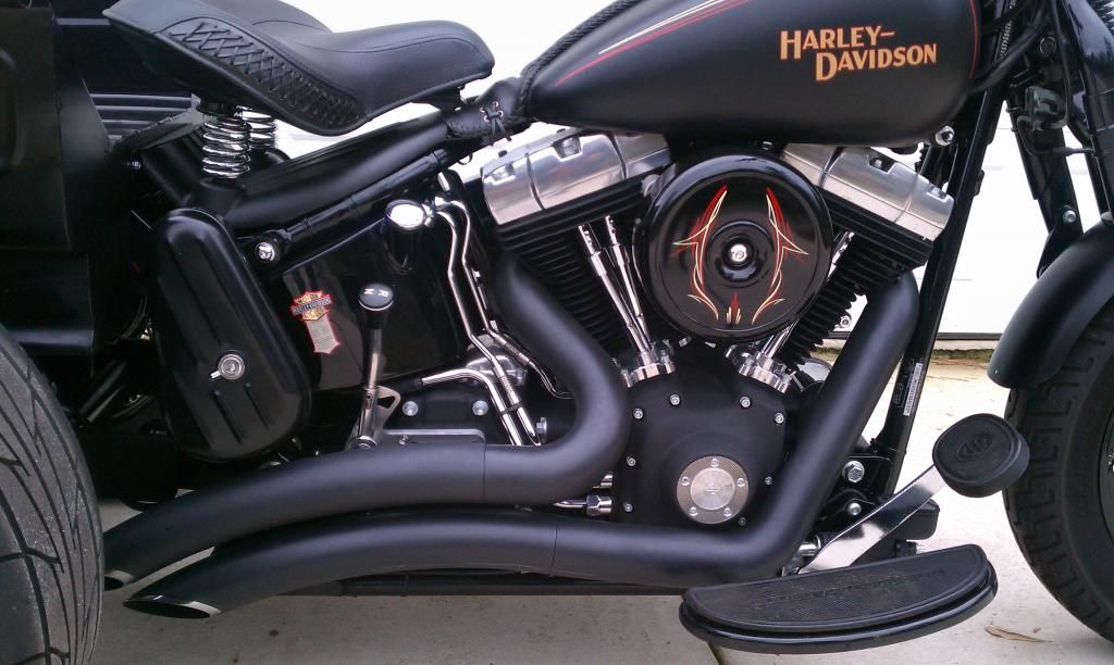

I'm using the Vance & Hines Big Radius 2 into 2. For bolt on applications you will need and exhaust that ends before the axle. If you want the exhaust to exit out back you will need to do some modifications to the pipe & muffler brackets or the exhaust itself. I went the easy bolt on route and have no regrets.

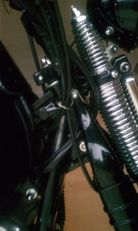

Forgot the rake part of the question. You will need the rake kit with any trike kit. Since my trike has a Harley springer front end there was no easy way to do the rake kit. I had planned on sending my front end to Liberty Sidecars where they are able to remachine the stem area of late models Springer forks to allow a 5° additional rake. The only reason I didn't do it immediately was due to cost and finances. I have now found a much cheaper raked stem kit which will be my next mod. I have been riding my trike for almost a year without additional rake and every bump and road irregularity is transferred right to the handlebars. If you keep a good grip on the bars and know what to expect from road irregularities you will be OK but you will eventually get the rake kit, so do it as soon as its within your budget.

'scotty....aren't most springer front ends raked a bit more than stock? Is yours a stock rake?
Also, the OP asked about exhaust....go to any muffler shop and they can do sleeved extensions...even bent if you need to clear the driveline.
I was lucky and my exhaust headers cleared the driveline. I just had Master Muffler make me two 12" extensions, and then made brackets to attach the mufflers at their stock mounting position.
Stock modern springers are de-raked so that the axle stays in line with the neck angle(rake) even with the long lower rockers. See pic below to get an idea of the de-rake.

In my case you are wrong :). On the highway and in smooth twisties my rake seems perfect. Around town with bad roads, potholes, manhole covers, bumps, dips, etc. is where my front end twitches with every irregularity. Might just be the springer though.
