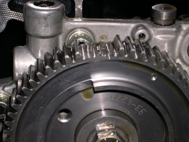

Good thing your not running gear drive cams, it would be sounding like a cement mixer right about now. One of the reasons running gears on an untouched stock crank is bad news just waiting to happen, kind of like what happened to this poor soul.
Ouch!
Back when the top end was completely replaced (due to damage from excessive heat), I asked if, "if I paid to have the crank welded and balanced, and paid HD to install it, would I still be under warranty?"
Answer, NO.
Crazy policies, that don't make sense, can be very frustrating sometimes.
